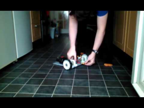

So I went to do the test run and... the receiver is busted. I had to check both motors, both ESCs until I found the fault that was stopping both motors from running at the same time. It appears one of the channels used for drive on the receiver is not working. At least it's a cheap part to replace.

So I’ve been using Wolf-E’s test platform to help get a sense of scale with parts yet to be added such as the Lipo battery mocked up in cardboard.
I came to the conclusion that it’s possible to add 2 more 12volt motors and using HDPE. I can make a 4WD weaponless CSB instead of Wolf-E.
