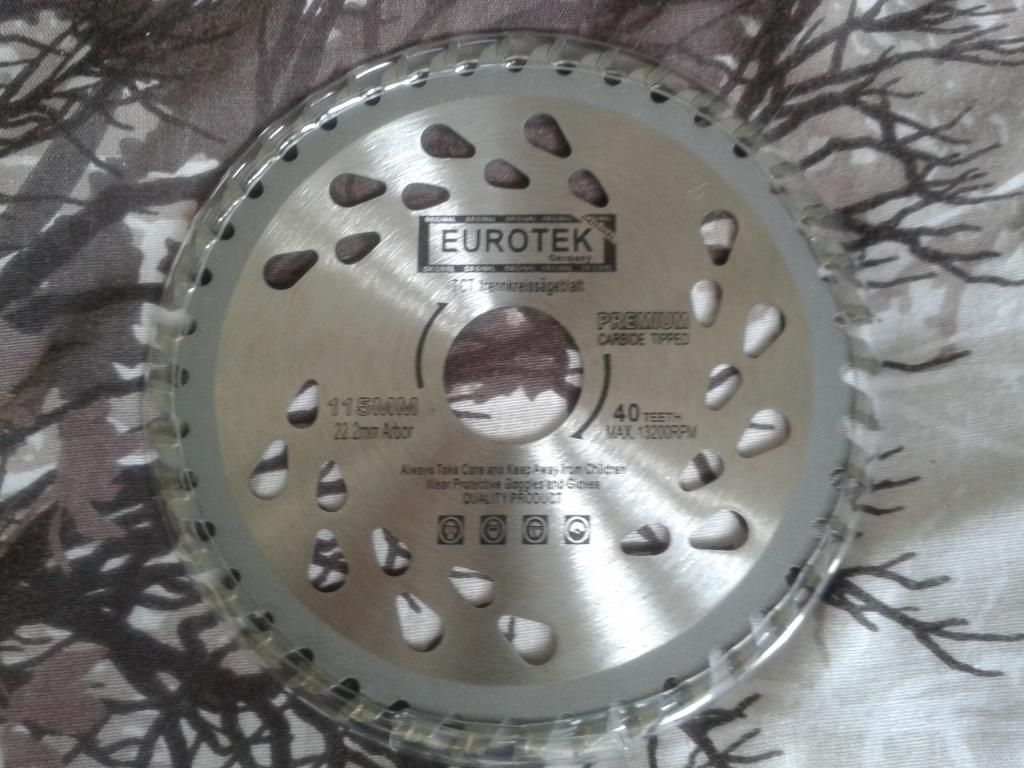

            Tiny update, after my circular saw crapped out yesterday I was left with no way of cutting out the hdpe bulkheads and supports other than hand saws, today however I've found a solution that I'd forgot I had. It's a saw blade for an angle grinder that should allow me to cut everything with at least some precision if I take it slowly.

              Don't think I've seen something like that for an angle grinder! It's likely to yank you and the grinder into the work or the work into the grinder... be careful!
              (and take pics)
              • #37
                Oh I'll be VERY careful, I'm going to take it really slowly and apply as little pressure as possible, im going to test it on an offcut first and if I'm happy it won't kill me then I'll use it.
                • #38
                  Pretty sure thats for a circular saw... putting it on a grinder sounds dodgy
                  • #39
                    With the disk could you just cut/file/grind a small flat on 2 opposite sides where the teeth will go that takes the material back by 5mm so it can fit? Would have to be carefull to get exactly the same off each side so it stays ballanced.
                    • #40
                      It's definitely being sold as an attachment for a grinder, I'll test it on an offcut and if it's too dangerous or doesn't work then I definitely won't be using it again

                          I would be particularly careful with cutting plastic - a grinder spins much faster than a circular saw and with a high tooth count blade, its likely to melt the plastic and grab. I found that the best blade for cutting PE plastics is a ripping blade with a low tooth count. The ease of cutting VS any type of cross-cut blade is amazing and they are also cheaper.
                          • #43
                            What Nick said
                            I use a circular saw for cutting HDPE with a wood ripping blade. Get good clean cuts
                            • #44
                              There was actually a blade with a lower tooth count but I brought this one because I thought it would be better, I'll test this one for now and if it doesn't work then I'll look at something else.
