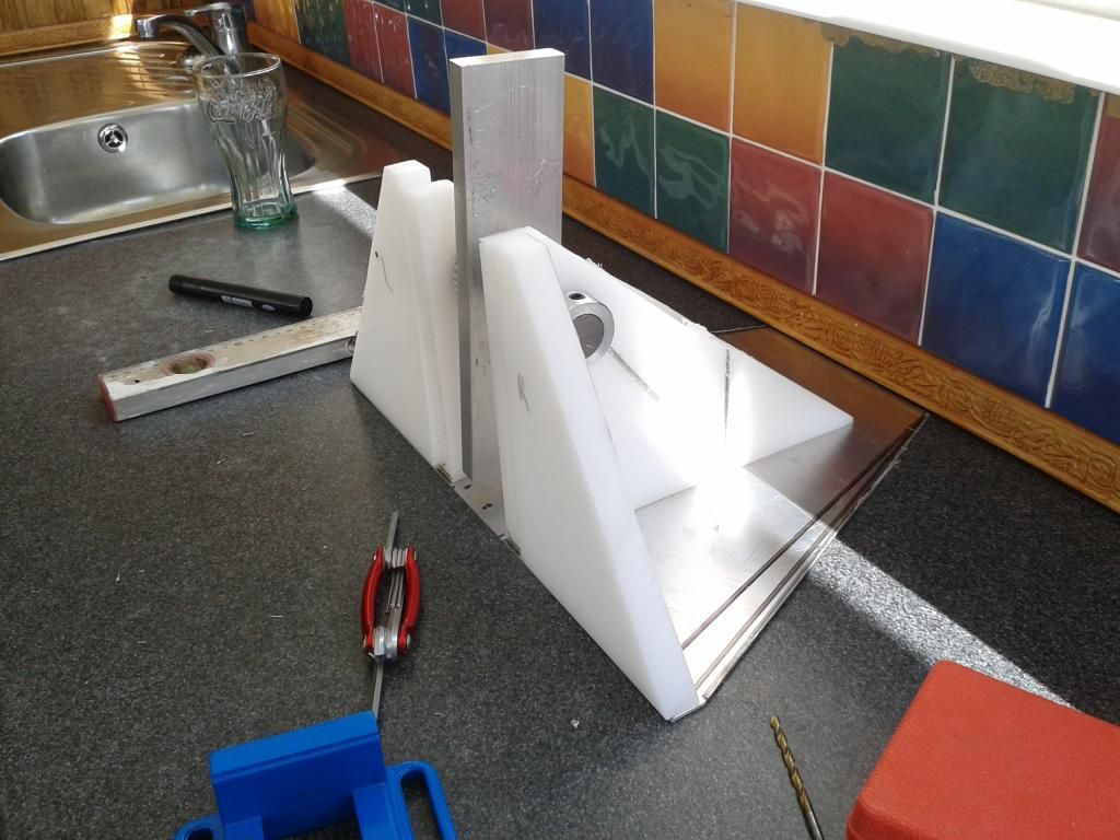

    Annnnnnnd it's done! well the large hole for the bar is at least, really happy with how it went, the bar is a 'little' off balance but nothing too bad i hope but i'll know for sure once it's all together. For now though here's some lovely pictures

              Spent a while trying to figure out where to mount the weapon motor that didn't involve cutting a huge chunk out of a bulkhead, turns out the gap between the two bulkheads is exactly the right size and with a bit of an adjustment to the shape of the back of the machine to protect the motor it should go in perfectly. The wiring for the relay/esc will need to be changed so I can move it to the side and I need to make some spacers to go in between the bar but other than that no problems, couple of pics for those interested.

                          Little update time, decided that i'm not entirely happy with the spinner bulkheads so i'm going to redo them. The bar isn't low enough and they were cut in a hurry so they are a bit messy, ordering up some more 20mm hdpe now so it should be here by Friday and i can crack on.

                                If you are not happy with the surface finish on the edges, you can make them mirror-smooth using a wood plane. As long as the blade is sharp and the cut is shallow, PE plastic behaves just like wood. I use a 'low angle block plane" like this:
                                They are usually available in hardware stores and are about the cheapest type of plane.
