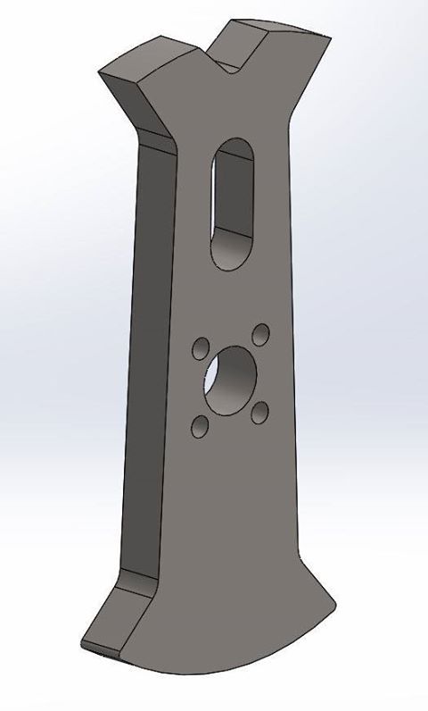

No progress as such but just a little update, I've decided that whilst Wraith probably would have been fine the way I was going to build it I doubt it would have been all that competitive. So I'm going to build it properly, sticking with the same chassis but the weapon is now much more scary on paper, I'm going to run it from an NTM 50 / 60 380KV @ 6s and I've had Alex (Botwright) design me a new weapon bar. I have to say it looks fantastic, it's based on IG 88's weapon but it's a single toothed, 20mm thick Hardox beast.
