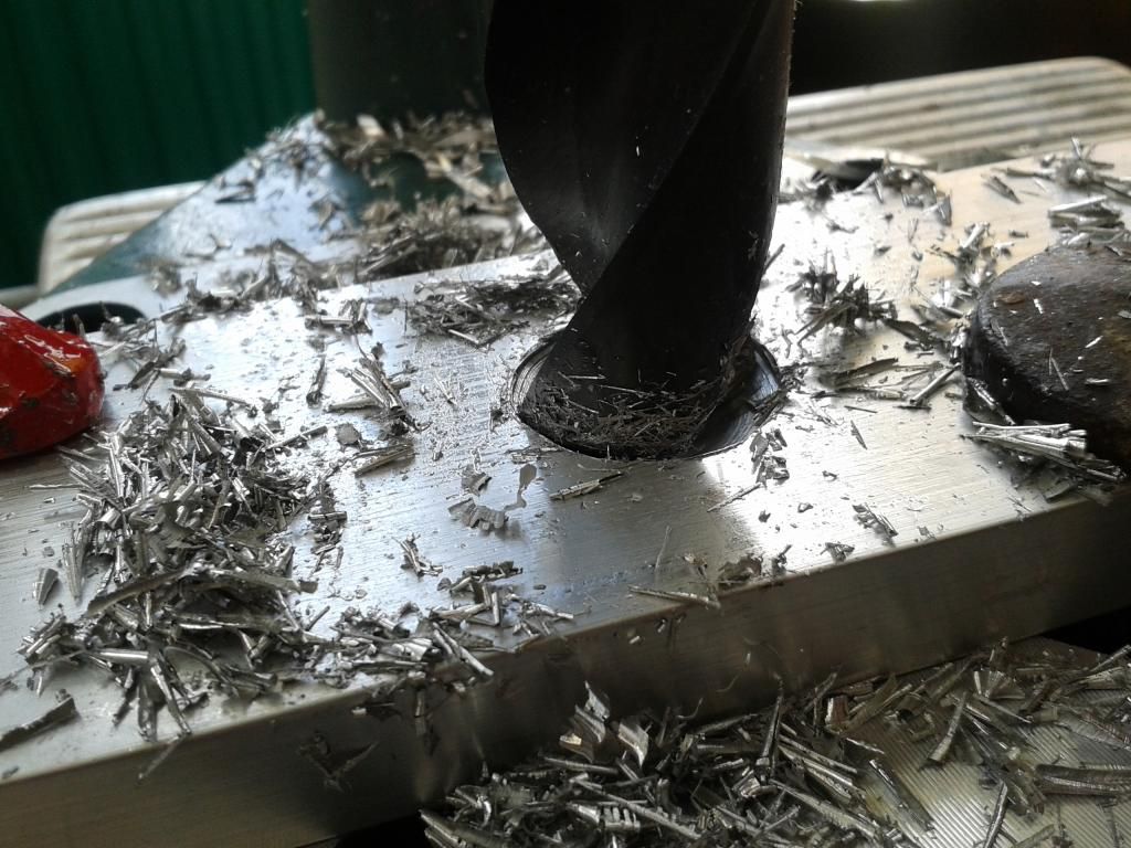

    I'll try the drill bit then, doubt it'll be fun either way but the bar should be on by tomorrow
    • #62
      Cut the teeth for the bar today and it went really well, the thin discs cut out both teeth in a couple of minutes and really accurately. These things are huge though and just for the record around 450g each.
