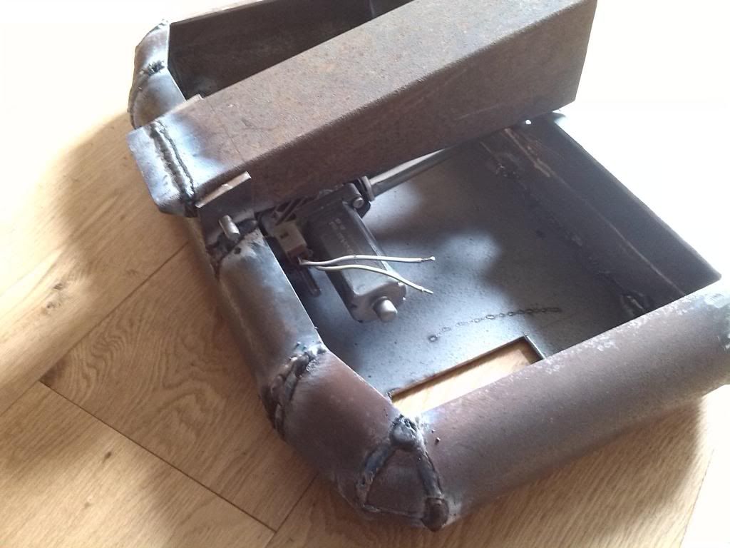

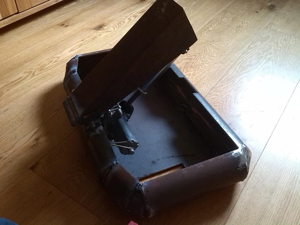

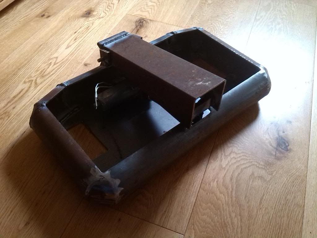

well im hoping the curved side will give the drum/ vertical spinners less to dig in to
right bit of an update got the actuator fitted in and allot of the welding i now done
next i need to get its new face made and make proper mounts for the LED/eyes, make a few interchangeable scoops, make the top plates, mount everything, paint it and wire it up
oh and some how make some 20mm long spike out of ti or carbon steel with a m4-m6 tap so will probably have to be 15mm diameter as i can really trust the goth spike to hold up anymore

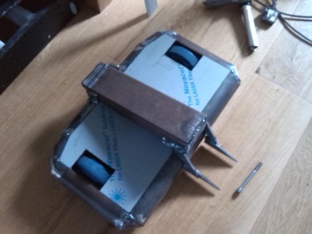

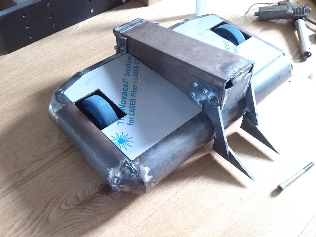

got a bit more done to scruffy 3 a have plans for scruffy 4
the top plates are only 3mm aluminium but i will be adding some 5mm hdpe to the and the front scoop will be more like scruffy 2s but probably wider, i will be going back to a 4s and adding a gyro so it will have the power of scruffy 1 with the control of scruffy 2 hopefully..... also the scoop will be interchangeable between a couple of designed
