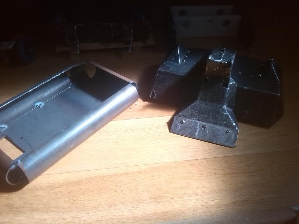

            • got bored on my day off after gsl so scruffy 3 has now started to take shape, i will probably have a gyro in this version

                      the new scruffy is mild steel tube cut in half, hopefully it will deflect the drum spinners better and if not it provides a good air gap from the electrics

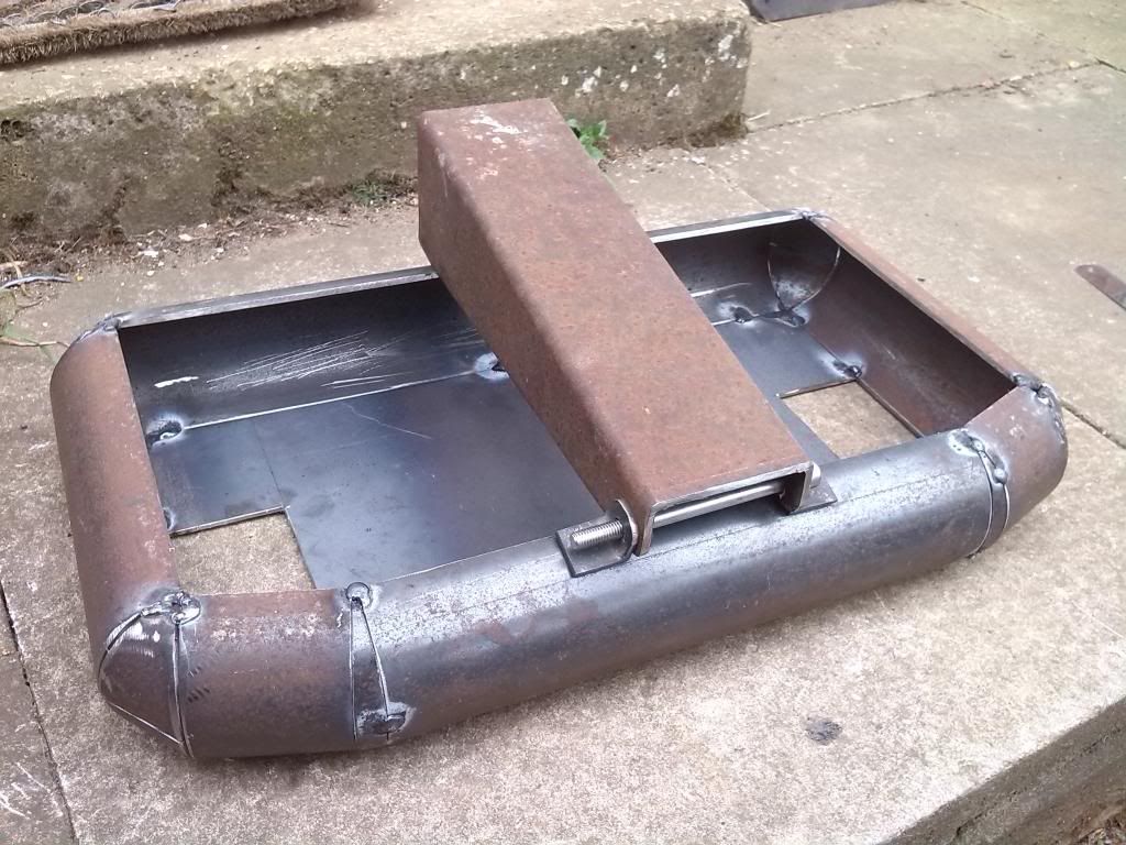

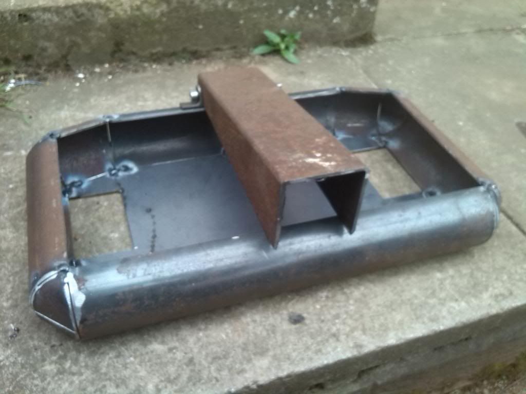

                        scruffys coming along nicely just have to weld up the chassis
                        found my large sheet of RG1000 that i bought from plastics direct, since its recycled UHMWPE and has similar properties it should make a good internal bulkhead/ motor mount for night fury which will be surrounded in 30mm hdpe
                        i should have enough rg1000 to make 2 sets of bulkheads which will allow me to test out the makita drives and if any problems occur i can then go back to my original ryobi drive setup

                          • Are're those curved sides just inviting flippers and vert/drum spinners?

                              also i had 10mm ground clearance on all my bots so flippers could get under easily enough, im hoping the curved edges will deflect thing better ...... at the mo each scruffy has been a trial of different body ideas so if it doesn't work i will go back to sloped sides like scruffy 2
                              • Scruffy 2 looked like it could handle the punishment quite well, the curved sides definitely make it easier for things to get underneath but also might deflect a hit better than say just a flat panel, regardless of whether it's a sloped panel or not.
