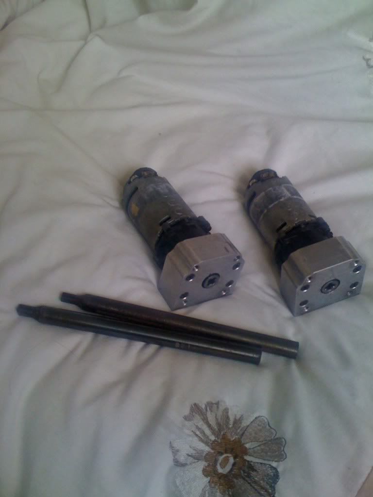

      got some parts for the new one
      Picked them up from an Aussie for $150Aus... not bad Also got a sidewinder, some 3.2mm hardox and some 5mm ti sorted for it. Just need some big billets of alumec89 now for the chassis, some ali bar to machine the wheels from and a lipo.
      Think I'm going to just keep 540 as a rammer for a bit to use at normal events- and to play with when 360 breaks down lol
      Not sure yet if i should go for 4WD or 6wd though.
      • Re: 360 - mini hypnodisc
        your bed sheet has flowers on it
          correction...
          My girlfriends bed sheet has dewalts on it
          Win.

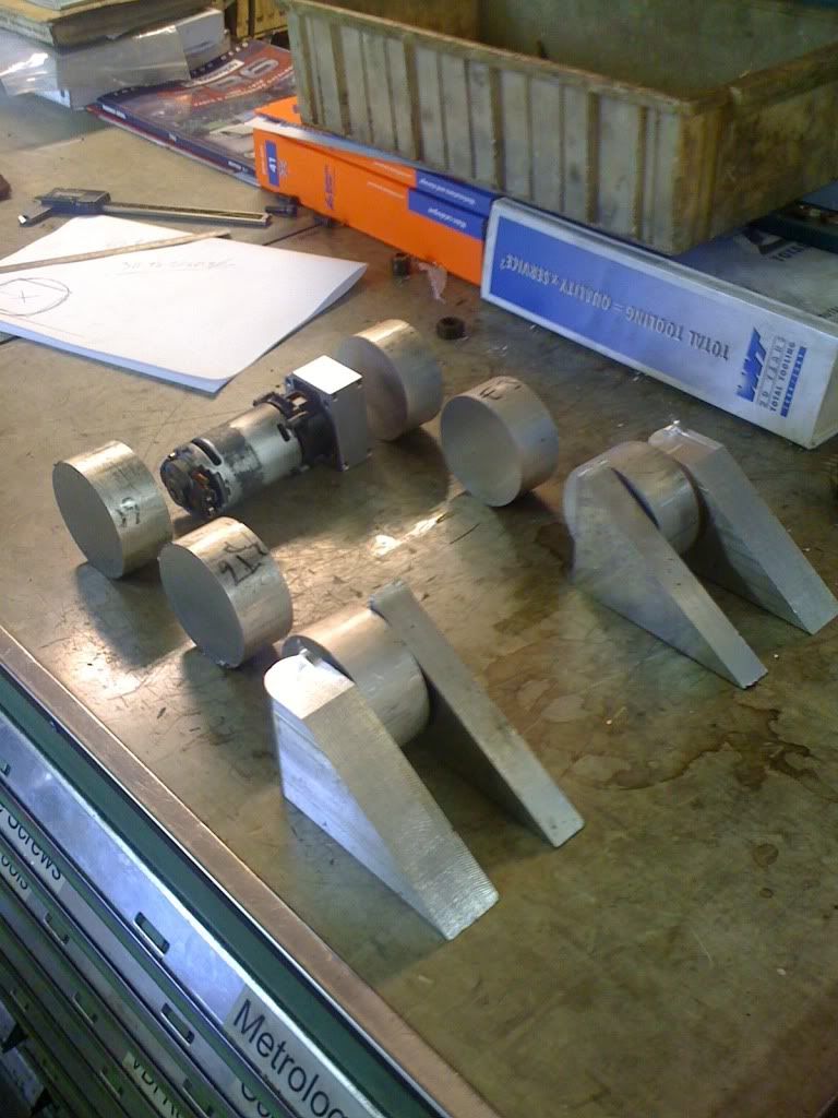

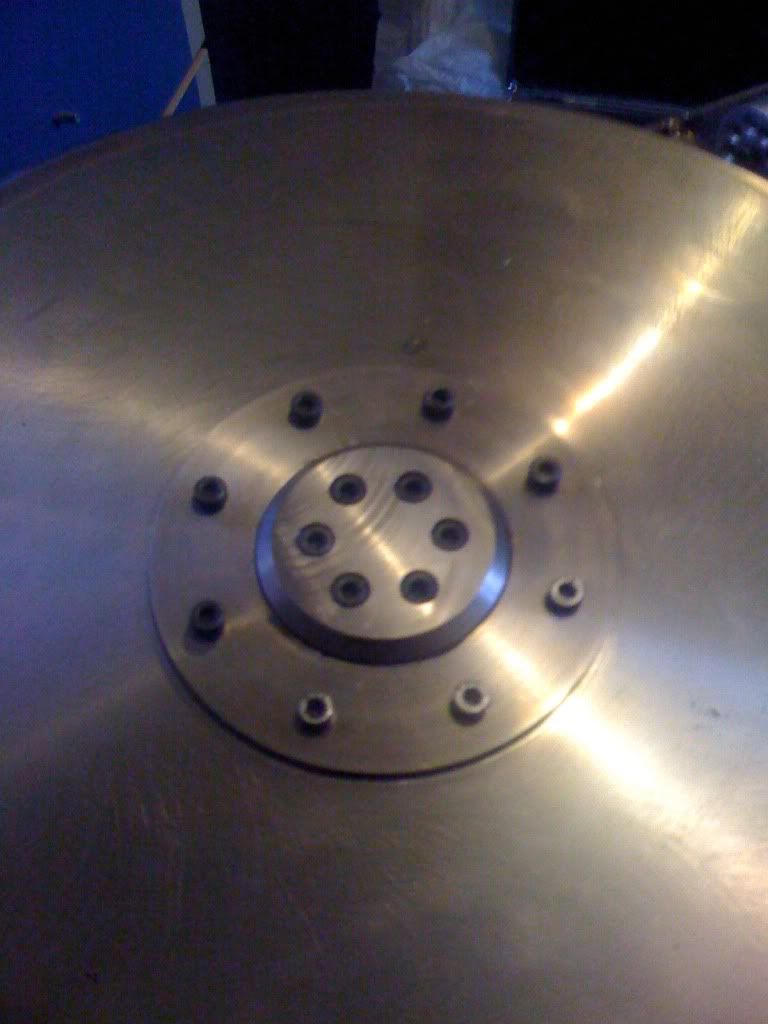

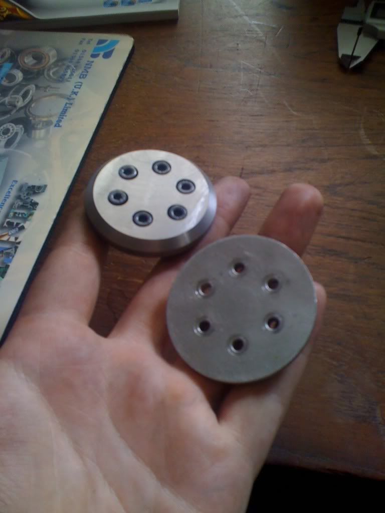

              Done a little bit today with Ed.
              New disc centre compared with the old ali one which bent;
              fitted;
              and some wheel blanks cut out of some ali round bar.. will be 30mm widex80mm dia when finnished;

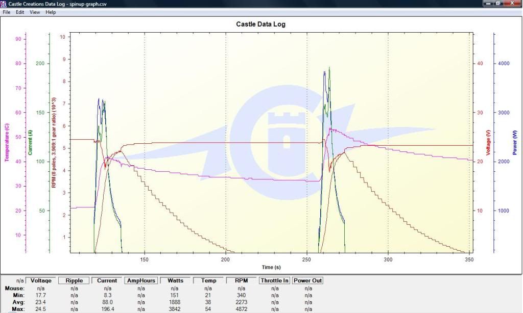

                Just as i found out im fighting Beauty in the uk's the postman nocked my door with a package from the states.. got my esc's back from repair... and feeling a bit enthusiastic i soldered on some connectors and got it going..
                The finished Re-wire job;
                Did two spinup tests, heres how they looked on the data logger;
                Somehow its over 500rpm faster then it used to be... More KE = more fun
