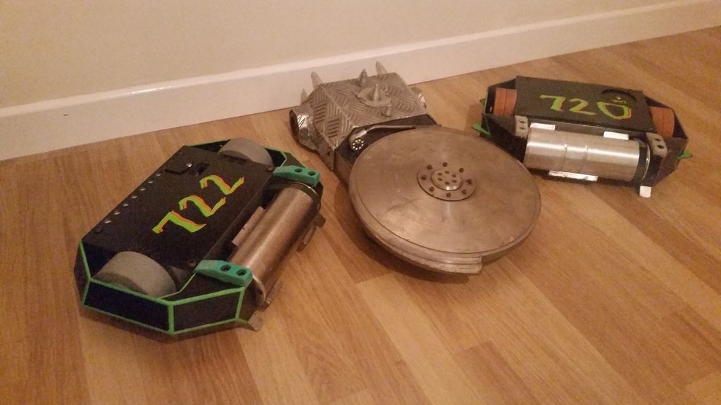

Got both 720 and 722 done early, so picked up 360 from robochallenge today where its been for the last few years... stuck some tz85's in it, tightened up a few bolts, put the link in and its good to go
wierd... spent years trying to get 360 to work and had loads of failures... neglect it for 2 years, slap it back together and it runs fine...
no idea lol just thought id take it... its sat in a display cabinet dead for the last few years... just thought if its gonna be on display it might aswell potentially run lol, id probably only demo it these days as its not worth getting it smashed...id rather keep it as a display piece.

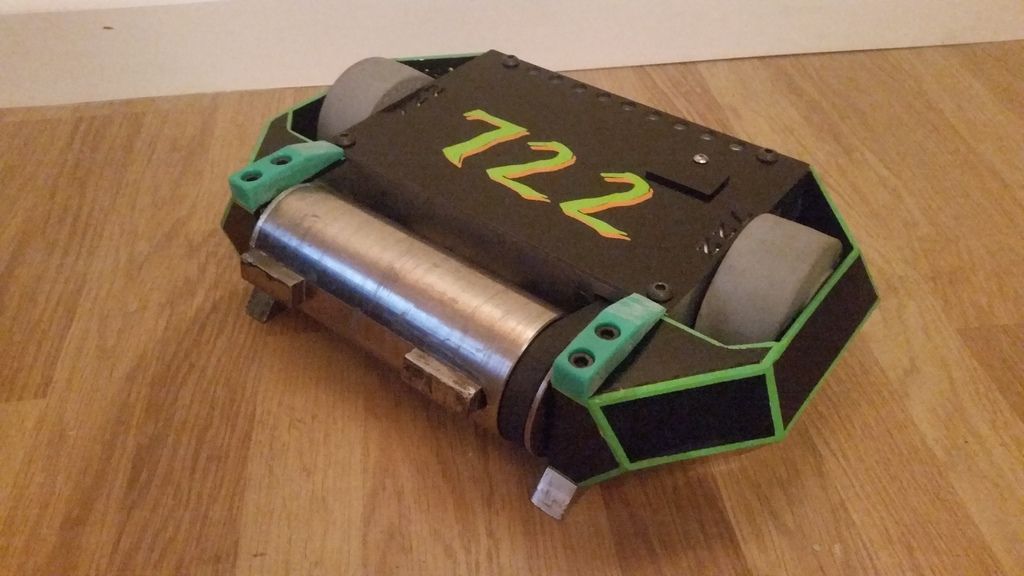

same problem again, it seems the speed of the drum is causing the grease to fly out of the drum bearings, causing it to over heat- this time against mr mangle and tormenta 3.... the esc over heated, so the drum stopped... tried to spin up again, fuse blew due to over current... so i tapped out to let Ellis and Nick go through.

New sharper teeth for 722 to improve engagement (was lacking this year as the teeth were very used)
New sharper longer skids to kill flippers with
lighter better grip wheels
top secret getting under super low flipper thing device
Hopefully 3mm titanium base to match the top
