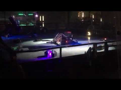

So far the only video with BOB 3 in it.
Well that was really fun, the only problem I had when a wire came loose, steering was in reverse and in the last fight the battery losing power.
1st fight
Apart from the steering I been trying to avoid the spinners and look what happens, also the back panel cracked.
2nd fight
It was going well until I got pushed into the pit.
3rd fight
On day two I replaced the back panel just to play it safe. Got knocked around a bit on its left side and getting flipped.
4th fight
I do not know why but that left side keeps getting hit by spinners, but with it beaning the last fight of the day it doesn't really matter how much beat up it gets. The only thing in that one was the battery dying on me.
