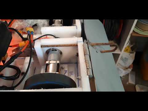

                          • With Robodojo coming back. I've been back working on my robots, I'm going to retire BOB 3 by putting it in full combat, give it a good beating. Right now I'm rebuilding BOB 1 as BOB 1 HD Remix, smaller, more compact, and more importantly, work.
                            The main problem right now is the locking bar for the lifter, it bends the bar a bit.
                            Just shows what a more powerful ESC can do.
                            • Hah, seems like what you have there is a steel bar bender! Look forward to seeing new BOB. Shame to think of BOB3 getting "retired" though, always thought it was a bit of a silent assassin at Robodojo, maybe didn't look as flashy as some but always put on a good show!
                              • Great to see a post from you Sean.
                                Technically the locking bar should stop the weapon from activating by accident and as
                                your weapon continues to operate with the bar in place it could fail a tech check.
                                Common sense says it is probably Okay on a slow moving lifter but to cure any doubt
                                you might use a stronger bar or mount it lower on the lifter blade to reduce the torque
                                force on the bar.
