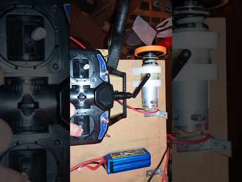

        Wiring results for the front motors.
        Seem to have a bit of the same problem as Wyrm did, might use the transmitter upside down.
