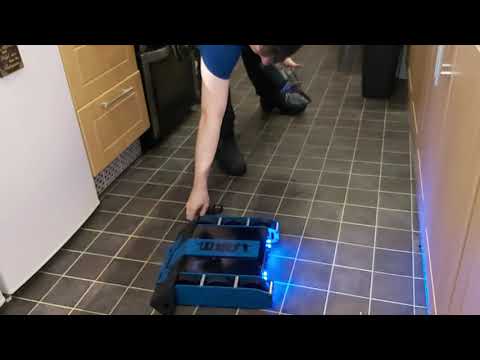

                            • After 10 months of work CSB 2 is ready for Extreme Robots Maidstone.
                              And a test drive on 4s can't wait to see what it'll do on 5s at the weekend.
