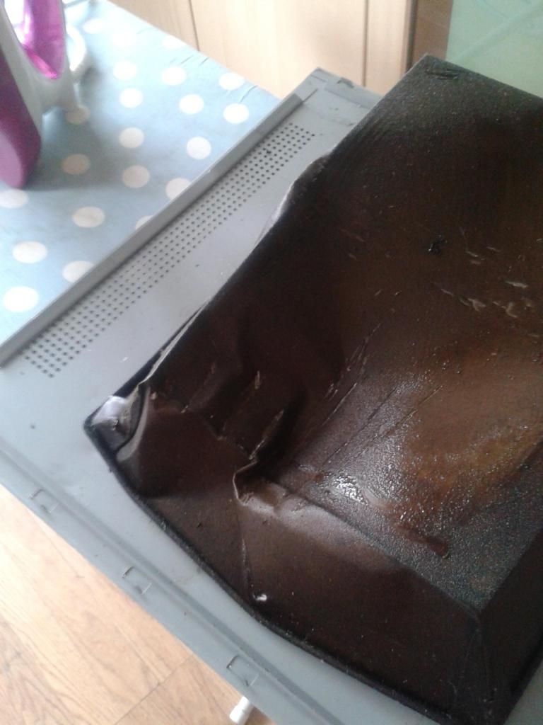

  • Just to prove that it does http://s921.photobucket.com/user/mrs...3406b.mp4.html
    • The aftermath
      • It's alive. ALIVE!!!!!

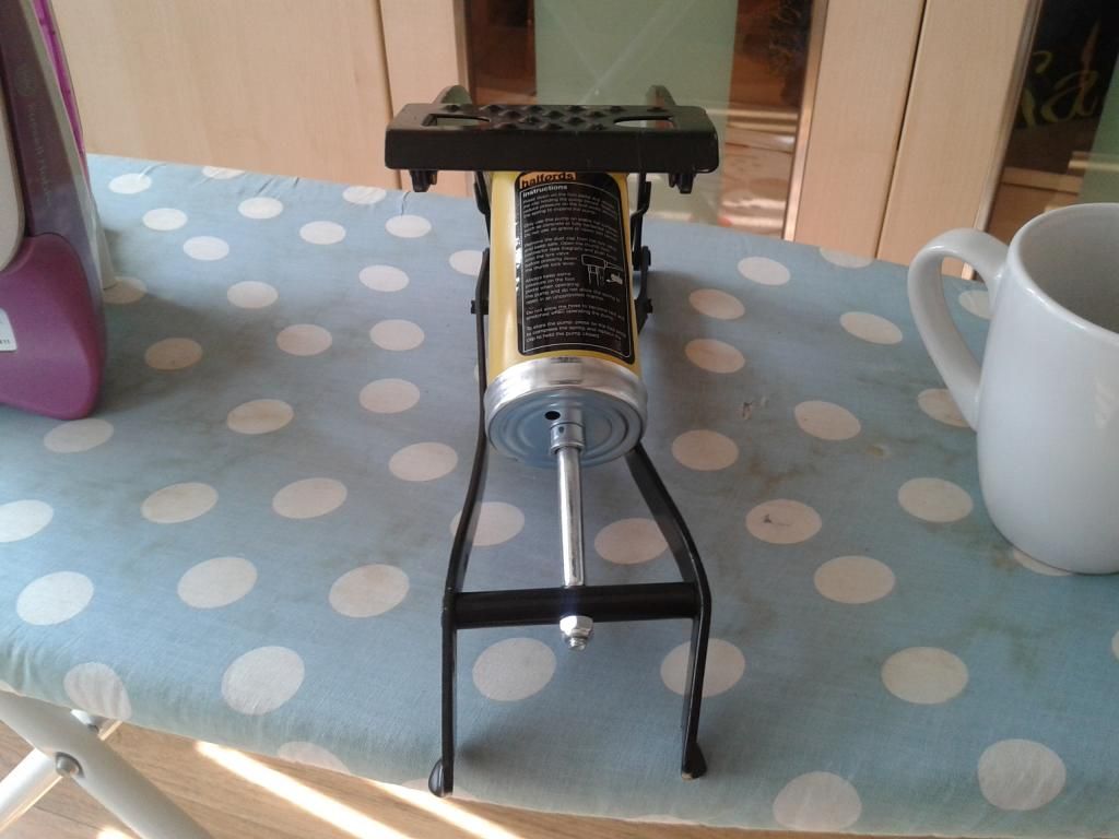

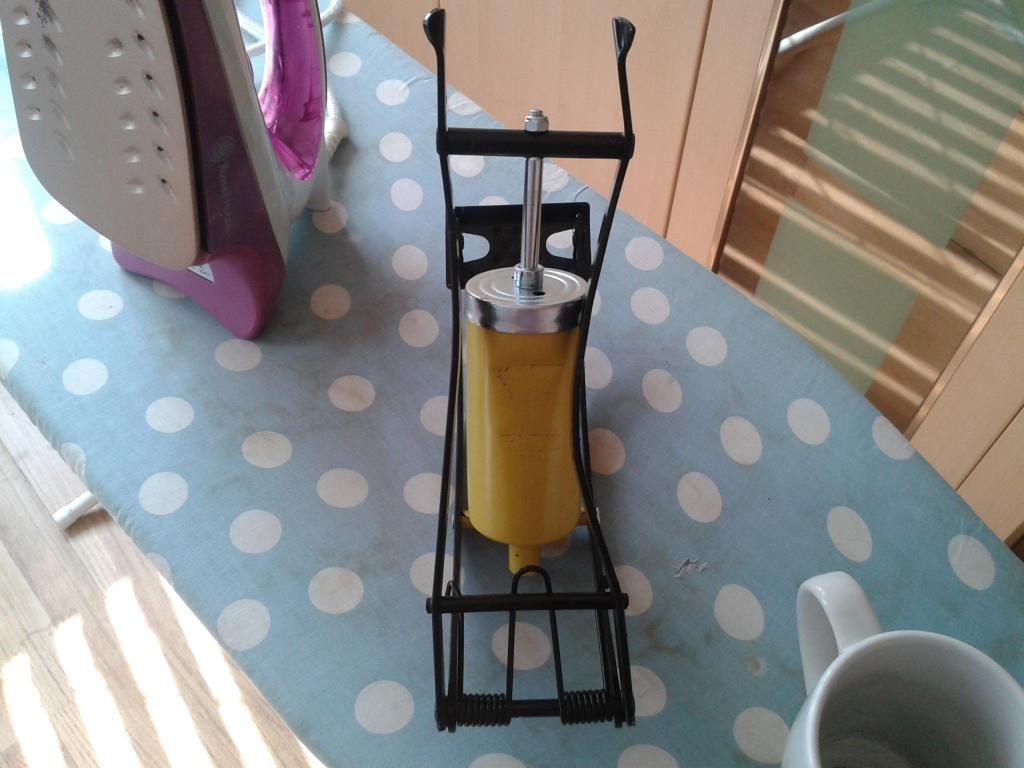

                    • I think you've got a point there Mario, something to look at for the future, but for now i found an old foot pump and thought "hey that looks remotely flipper shaped let's see what happens!", apparently this happens
                      • I think you're a few years to late.
                        The Rex Garrod challenge , a starter class mandated these kind of setups, powered with pressurised cokebottles @50 psi.
                        (of Cassius Fame, and together with Arfa, one of the elder gods of Robot Wars I worship.)
                        • Sorry Mario i should have explained, i wasn't trying to turn it into a flipper i was just using it as a flipper robot shaped thing that the axe could hit
