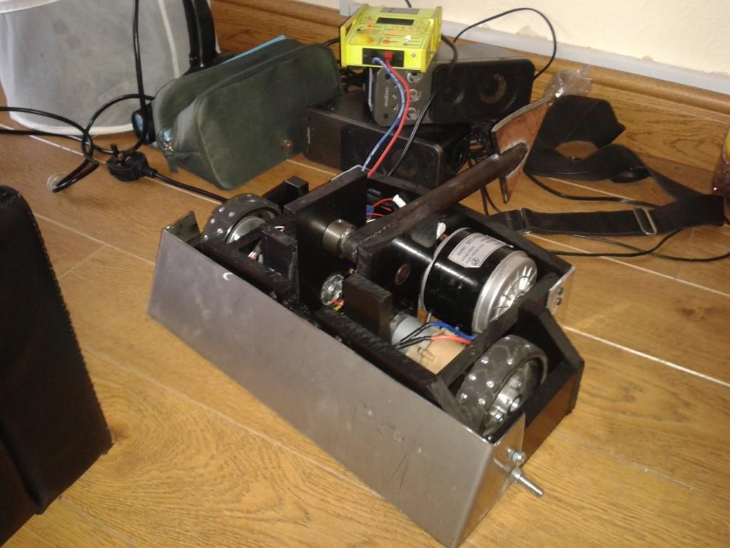

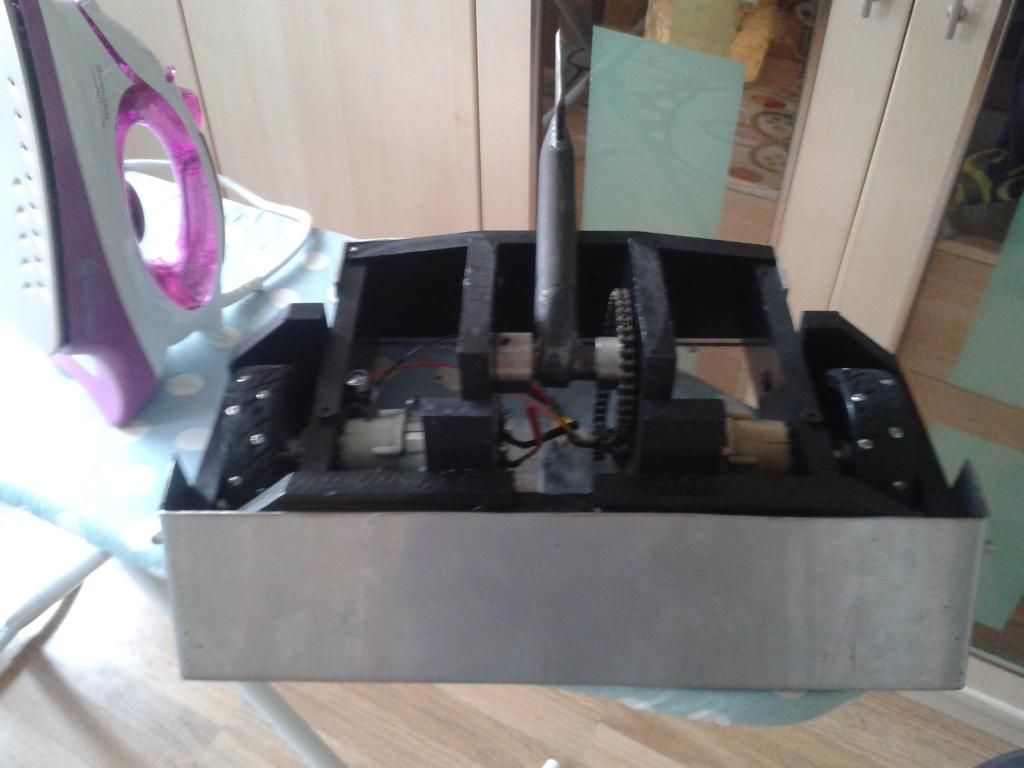

      • So i was in the middle of putting Hatchet back together and i've been called into work early but i thought i'd just post a couple of pics to show the new scoop, i think it really completes the look of the machine, i do need to cut the bolts down on the sides but here it is....
        • The steel armour makes it a much tougher proposition to beat - is that some more steel around the back?
          • It's Ali at the back, only brackets holding on the HDPE plate. The front is only 2mm stainless (better than nothing). I should have made it from something thicker.
            • What Dave said, tbh the front scoop is only to help get underneath other robots to help with pushing and to stop the front of the robot jumping when i fire the axe it provides very little in the way of 'armour', the ali at the back is just to brace the corners so a spinner couldn't get so much of a grip and pull the join out. The back and sides will be getting some 11mm polycarb as extra armour so hopefully Hatchet should stand up.

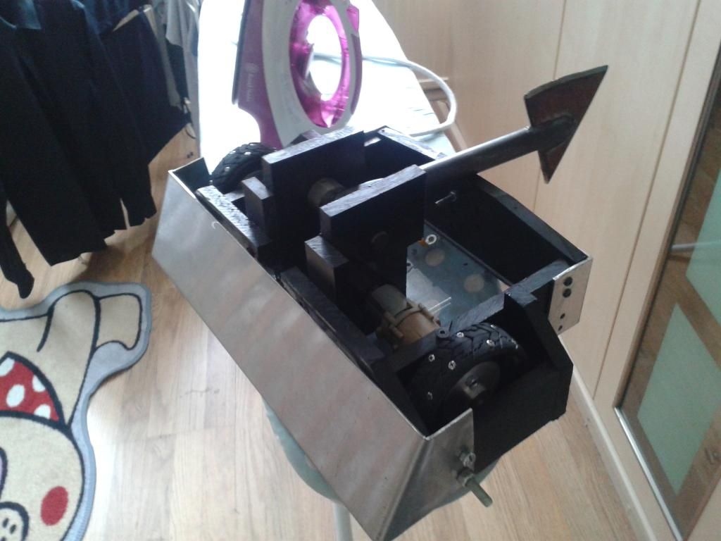

              • Spent today putting Hatchet fully back together and just generally checking everything is how i want it, all that's left to do now is make up a cradle of some sort, a top panel and knock up a couple of spare chains. Here it is just having a pre test charge...
                • Looks good Sam, looking forward to our fights started painting today, although all may be in vain
