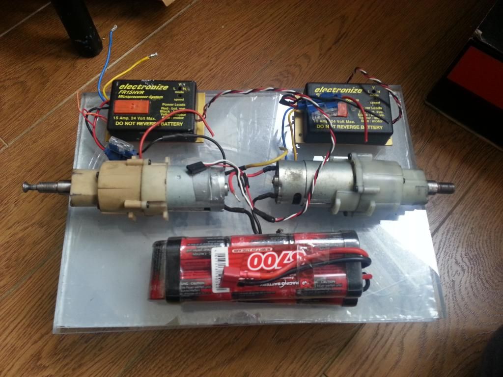

                I have finally got my act together and started getting all of the parts together ( left it a little late but oh well), here's what i have so far

                    I should add the parts are just laying where i could be arsed to put them, when it comes to building it will be a better layout
