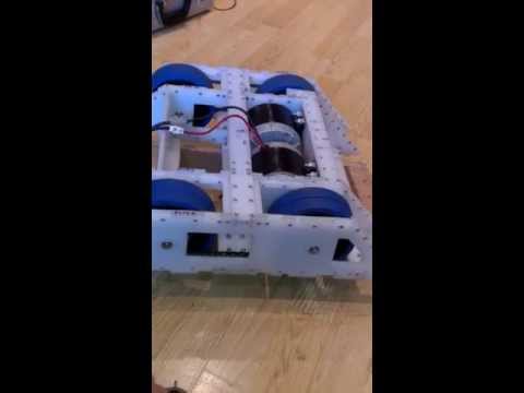

Only a few hours to spare but I knew I had to fix the travel on the wheels. One wheel on each side was fine so I transferred them onto one now finished side.
I dismantled the remaining wheels and worked on re drilling and fixing them and amazingly managed to completely fix one wheel.
The other was beyond repair and I had to use a spare bane bot wheel which I haven't used. Re drilled and reattached the spur gear and also completely fixed. Funny enough the new finished side is far better then the old finished side
Also I managed to get the ni-mh pack to charge properly after a few cycles.
Here is the test with a wotty and the 24 volt pack
Sadly all the youtube enhancments will take a few hours to process so excuse the shakey, bad colour and sideways video till it sorts it self out

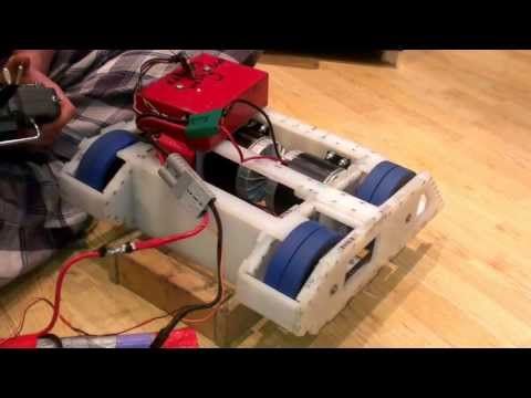

Managed to have thursday evening to my self to wire it up
Not terribly exciting news but surprisingly time consuming. And now I finally get to test drive it....yeeey
This is how it runs in a tight empty part of my front room with half a charged pack. I hope to at some point go to my local gym and really open up the throttle in a sports hall. Apologies as I got my half asleep fiance to film it before bed and the framing is a bit off.
Wiring isnt as tidy placement wise as I had hoped but no open terminals, no weak spots and thick gauged wire to supply the current to the beefy motors. Have three untouched cables (12volt out for weapon, 24volt LED and ground).

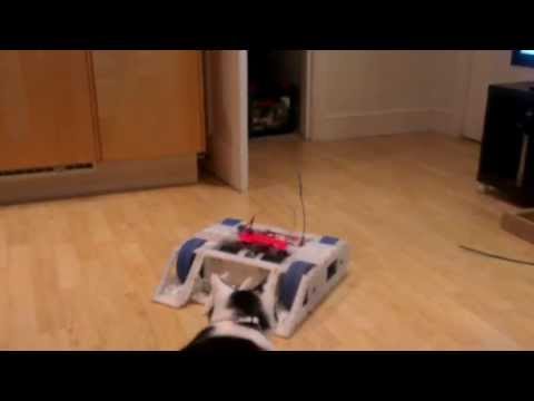

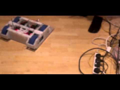

Still haven't had the opportunity for a test drive. Would like something nice and flat to test its speed.
Decided to have another drive in my front room with fully charged batteries. My cat has been constantly curious about the robot so thought I would see how she reacts. Not remotely scared. Dont worry, I didn't come close to hitting her but do stay and watch till the end.
