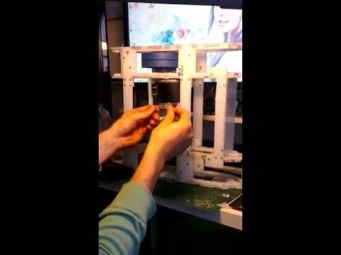

Here is a video of testing the first stage of the drive.

Most of the week I have been creating the transmission. All the wheels are constructed with the attached gears and sprockets and I decided to test them out.
Job which had to be done was replace the motor mount. Currently its a weight reduced 6mm nylon plate which is bending horribly. So I replaced it with 14mm non weight reduced piece (because thats the way I roll)
Fine now and the first stage reduction is smooth and perfect.
Once placed in I realised that I was literally just 1 or 2 mm of from attaching the perfect length chain. I managed to get those in by drilling the bearing holes a bit closer together and the chain fit fine after.
While testing the wheels I am really happy with the transmission. However some of the wheels have some travel. Not up and down (which would mean that the robot bounces around when driving) but side to side (could rub against the chassis). Only by a couple of MM but perfectionist mode is active.
Not sure how this happened but probably in the process of creating and attaching them to sprockets. So I went about finalising a side. Managed to fix one wheel which had too much travel and put spacers in the wheels. Also cut down excess wheel shaft. Side runs very well and even though there is a tiny bit of travel. It would be hard to notice.
