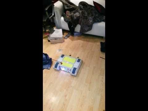

                    Trojan 3.1 completion
                    Righty as you can see, build diary out the window. But for good reasons. I wanted to keep some new features confidential!
                    From the bullet point list of changes:
                    Better visually.
                    Trojan III is no longer a ramp with 4 wheels. Well it still kinda is but I have cut up and welded the front scoop so its a bit more dynamic. This should fix the buckling issue as its very well braced.
                    512 rgb led pixel matrix
                    The back panel has been replaced with polycarb and now holds a rgb panel! This is fully controlled via bluetooth to a smartphone and can play animations and graphics on the fly.
                    I had to construct some new internals for it all to fit together and it should survive the stresses of robot combat fingers crossed
                    I am very excited about this mainly because it so far looks awesome but also adds so much visually to the arena
                    Weapon downgrade
                    The drill controlled prongs has been swapped with a servo controlled prongs. Actually the prongs just run across the floor and a servo pushes against a copper rod to lift up the prongs to the right height to avoid getting stuck.
                    I had to get the weight for the other upgrades somewhere and the drill motor shaved a substantial amount of weight. I have found a cheap supply for 20kg torque servo motors. I have ordered a couple and I may see how high torque servos cope for prongs in the future.
                    Pictures and videos:
                    wip pictures
                    2013-09-08 11.48.11.jpg2013-09-25 17.07.26.jpg2013-10-02 04.12.34.jpg2013-10-02 04.12.44.jpg2013-10-02 04.12.19.jpgFuture upgrades for Trojan 3.2

                            • #74
                              That looks awesome marco, very tornado like...
                              If you keep the front end onto the spinners they'd be lucky to damage it.
