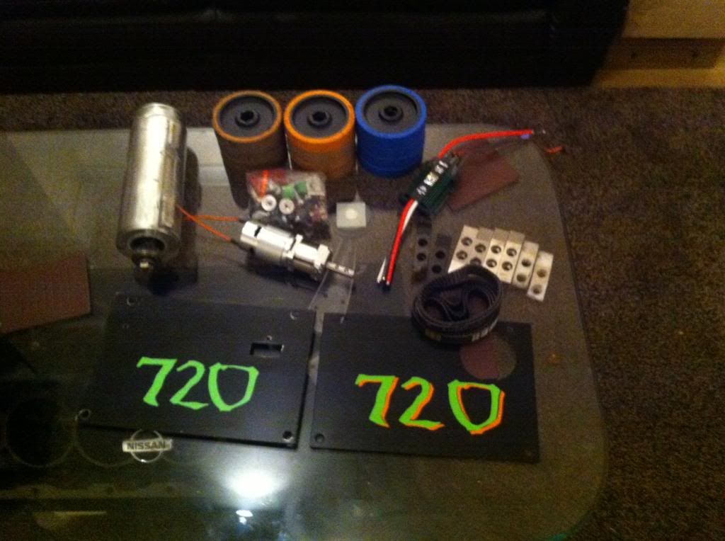

  • Well… a lot of people are doing updates thick and fast to there build diarys and flapping that there not ready so i thought id post where im at;
    Got bored so took it all apart, re greased the gearbox's- messed about with the brushless motor a bit, and loctited everything and put cable ties around connectors etc;

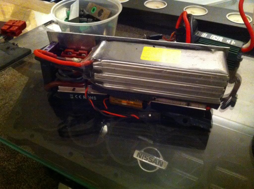

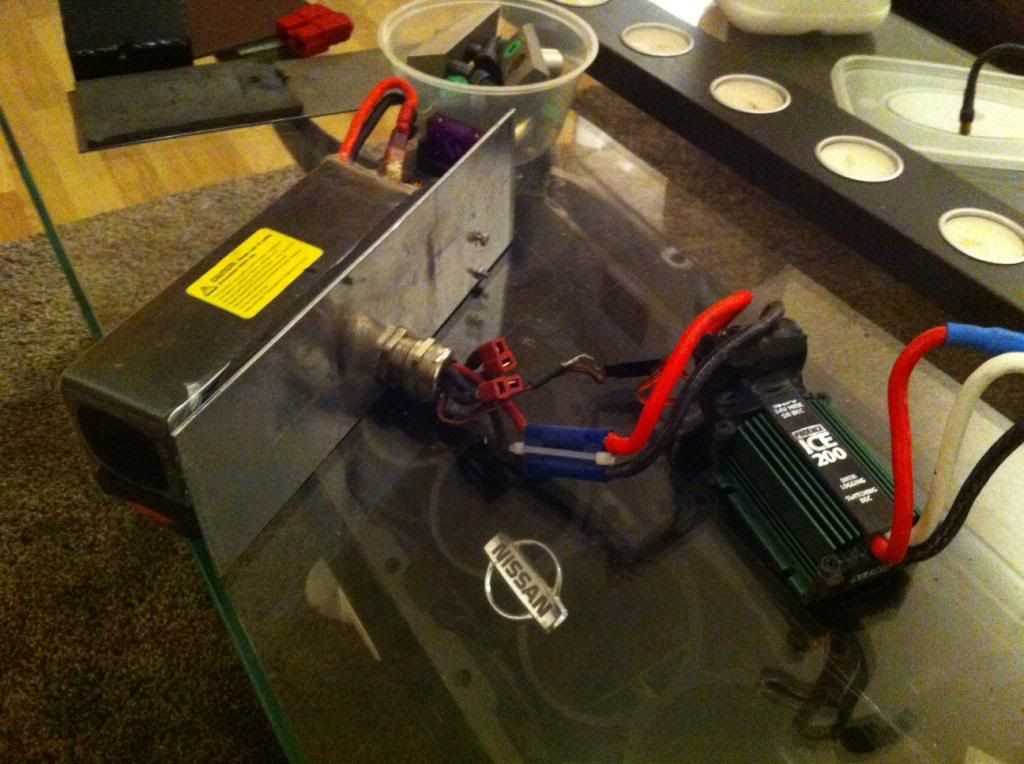

    have a few people comment on how small 720 is… this is how… the electronics are very compact in the back;

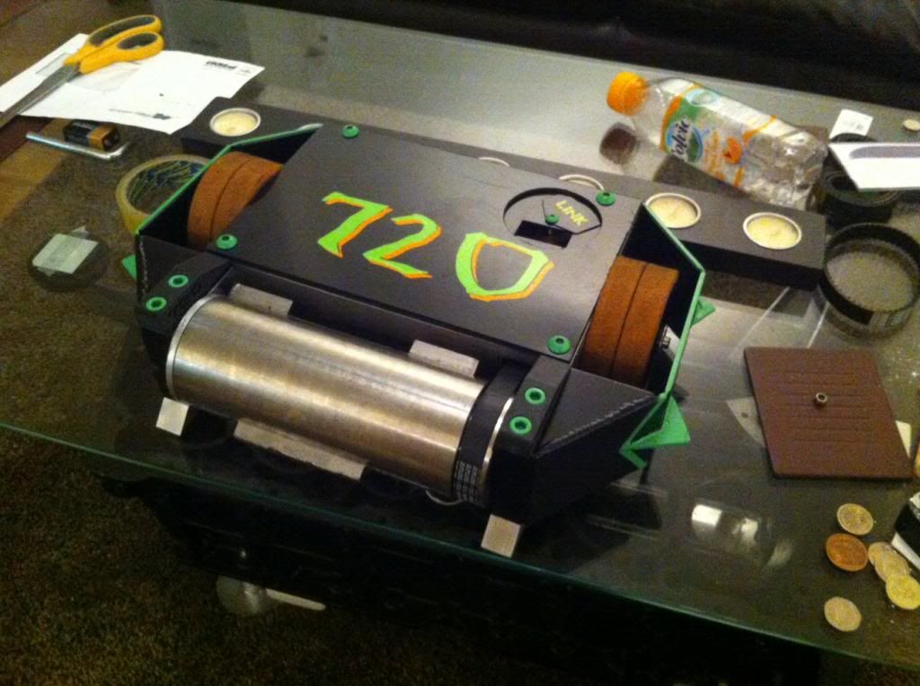

    I noticed the amount of axe's signed up… decided to make a HDPE lid to go on top of the titanium just incase;
    Liked how the pits operation got compared to F1 style this year… i cant change the wheels in 3 seconds, but ive got a decent amount of spares this year… no spare chassis, but i presume john lear will have enough to go around on the day lol…also got a spare tz85 on its way from Aus which Nick kindly said he'd bring for me;
    current weight with the stainless wedges and the hdpe lid added is 13.57kg… 30g's to stick some foam in the top over the lipo, then just need to stick it all in the car….don't know how I'm going to fit it all in before next wednesday but ill try my best
    • How come you have so many spare wedges? They look like the last part that would break...
      If the pits have to be run like an F1 race, are we getting F1 grid girls too?
      • He can change sets to get the drum even closer to the ground and in case they get chewed up my another spinner. Even if its just the leading edge that gets bent then they are useless. And because he can :-P
        • Nah they all started of the same height- although the nylon ones I had fitted last year are worn down and now the drum only has 1mm of ground clearance... I got 2 sets of stainless ones that I'm keeping back to fight wedge bots with, no point blunting them off against robots that don't even have a wedges

            • 720 didn't have the best luck this year, only really lost fights due to it breaking down which sucked…
              the motors kept blowing for a few reasons.. the main one being the weapon has now improved alot… which when i get a big impact puts alot more shock through the robot- causing the lipo mount to flex into the drive motors and knock them out of align… so the lipo box will be going from 2mm rubbish ali upto 5mm T6 for next year…the thunderpower pack also failed causing the low voltage cut out to kick in, meaning next year im going to upgrade to optipower… which also saves weight and space inside the robot.

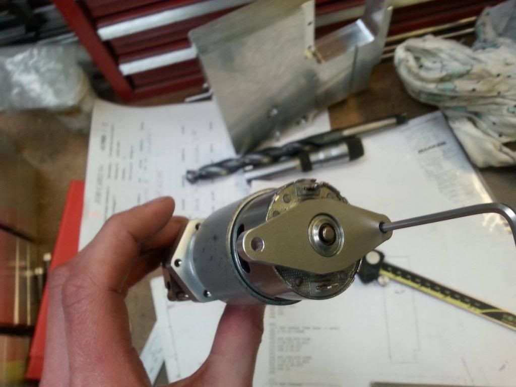

                  Also i came up with an idea that callum has put into process for me to help strengthen the motors up, as it became apparent that the g-forces in the robot could also bend the motor front plates, as their pretty damn weak… he's nocked up some motor enforcement plates for me, and made a few spare sets if anyone is interested in purchasing some to fit the banebot p60's…he'll be selling them for £30 per motor… that includes a custom motor front plate to fit the gearbox, the rear motor retainer and all bolts etc to fit. PM me or him if your interested in a set.
                  • Those look the deal! Would probably have a good market in the US.
                    • That's excellent work, is it a whole new backplate on the P60? this would be just as useful on smaller motors - I regularly have 540 motors bend or work loose.
                      • Yeah it's a totally new back half if the gearbox... don't see why it wouldn't work on a 500 size, the rear support plate might be slightly over sized though...
                        Forgot to mention the holes are M4... Not the dodgy American imperial size the p60 comes with as stock.
                        First set provisionally sold looks like these could be popular.
