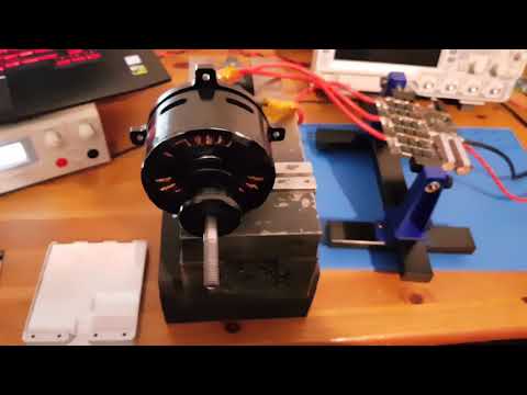

              • I spent a lot of time testing over the last few weeks. It is now possible to run a motor using FOC.
                Sending a prototype unit to Rory Mangles to see what he thinks.
                Currently I have tested:
                100000+ ERPM - Seems fine, tested at 105000ERPM, will try testing with a higher Kv motor and see what the limit is.
                100A continuous - Seems fine, motor got too hot and started smelling. Will continue with larger motor in tank of water.
                Motor Tracking (Coasting motor) - Working up to 4000ERPM, working to fix at the moment.
                BLDC - Not working, probably related to motor tracking issue.
                FOC - Works fine, but detection does not work (Motor tracking). So you have to enter motor parameters manually from the detection.

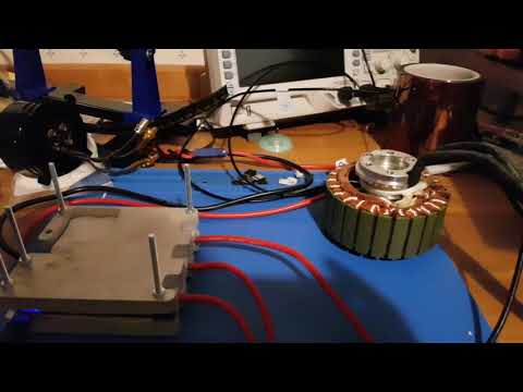

                I designed a new heatsink which can be waterjet, hopefully keeping the price down. The design allows multiple controllers to be stacked to allow them to share heatsinks. The plates are 10mm aluminium so you can just drill and tap holes wherever you like to mount them.
                Here is a video showing it running. (Excuse my brain fart on the ERPM graph)
                • The heatsinks also arrived and look great, thanks again KCut! So have now tested at 190A (Max my powersupply can do) so far it manages to run for 25s before hitting the temperature limit and throttling down to 135A continuous. Although this is clearly because the thermal transfer between the board and heat sink is not good enough. So I have some better thermal pads on the way to try out.
