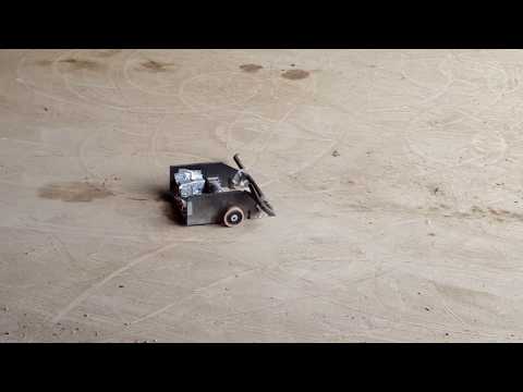

compared a odd pog of currnely building which I might rename to "Bodgesmith"
Looks tidier than my featherweight
