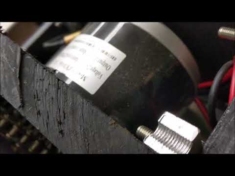

But now the bad bit. I think i have damaged the weapon motor as it does not sound heathly
Can it be saved or should just invest in a new one (+ plus a spare)
Does sound horribly bearing related. I guess there isn't a gearbox attached to this one?
I'd be inclined to leave it for the moment, get to an event and then see how well it is doing during/afterwards, 8mm steel is fairly beefy stuff, I doubt there'll be much with that sort of armour running at the moment, especially up on top in a world of spinners.
