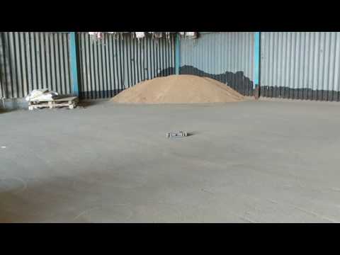

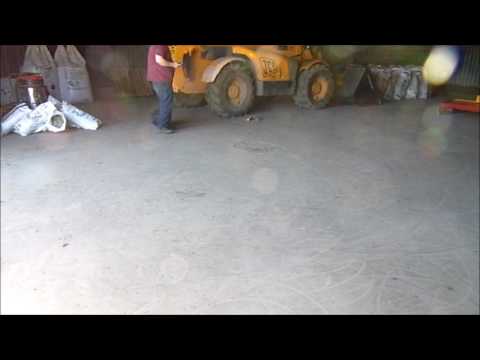

Sounds like the esc are slightly different setup, are they programmable ones at all? They may have their topend output different. Note they direction they spin in at top speed and then swap the esc over to see if it makes the robot spin the other direction. This will narrow it down to the esc.
It's a combination of weight distribution and having your drive motors at the front. I can't remember the exact explanation behind it but basically robots with front mounted drive wheels are much harder to control. Most robots have their wheels either centered or rear of centre for better control, and most of them won't go in a straight line in reverse, they'll pull to one side like yours does in forward.
