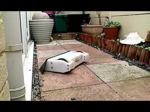

I recorded the test drive but I noticed that the lights were dimming when I gunned the drive. I did a bench test and couldn't understand why that is doing that. I then found that my motors twitch when I arm up plus there seems to be a clicking noise when I insert the removable link. any ideas why I'm encountering this?

Thanks for the response Paul, from what you and others on facebook have said. It looks like the motors are drawing some currentOriginally posted by PaulusSmallus View PostFirstly, I am not an expert in building robots, so someone may have a much better suggestion.

away from the LEDs but has they still function fully when the robot is still they'll be fine.
So after some thinking I felt that the light dimming needed to be addressed despite other roboteers on facebook saying it should be fine. And sure enough it was a simple problem and a simple solution. Basically the LEDs where under voltage due to running them in a series that required 19 volts and I'm running CSB on 16.8 volts at full charge from the 4cell lipo battery. In order to fix the issue I simply bought some resisters that could help run the LEDs in two parallel sets of 3 and after a afternoon of rewiring the LEDs CSB's lights barely dim and are far brighter now.
