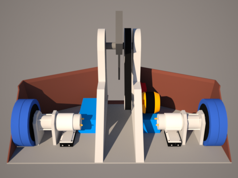

      • The initial design weighed in at a theoretical 12.6kg, with the 6S 5000mAh 50C Lipo and 16:1 gearboxes, assuming the weight of the bar to be in the realm of 3kg. This factors in everything, the weight of the belt and pulleys, the 20mm weapon shaft, bolts and 8mm ali motor mounts. With the bigger and slightly heavier 64:1 gearboxes and 2 5S 3650mAh packs instead of the monster 6S, it comes in at 13.1-ish, allowing a bit of room for error. This is the current layout in CAD:
        As you can see the two batteries and slightly longer gearboxes fit into the chassis easily.
        I always design towards a goal of around 13kg so I have some spare weight for error and/or any modifications or additions that need making. On 10S the weapon ratio would need to be ~2.5:1 to achieve the 7000rpm desired. The 64:1 gearboxes will give a max speed of 5mph, which is a bit on the slow side but might come in handy in a pushing match, not to mention the added control it'll give.
        • Cheers Nick! I hope so, I think with 60mm of bite and 3.5kg of bar, it may end up getting a few big hits! Just need to make sure everything's up to scratch when I build it to make sure it can take the force in the case of a really good hit... would hate for it to break itself!
          I'm not too sure of the MOI of the bar, I'm sure that the weight is 3.5, though I may need to double check with Alex on that one...
          That's a shame too, but I guess I could work with that. I always thought that it was that the motor always kicked out as much power as it had on tap, but efficiency and speed was dictated by the voltage... Might mean a slight redesign, I do like the idea of split voltage (seems to work great in Mr Mangle) so might be a route to explore. Failing that, I'm sure there could be other lower voltage motors to fit... could be a case of going for 5s and running it all off one beefy pack or something!
          It might be a little bit fast too Dave, it's just a shame that Banebots don't really do anything between 16:1 and 64:1 reductions! Granted I could get smart with some belts and do a 16:1 with a 2:1 from motor to wheel, but I'm not sure that's the best way to do it... I could also have something custom made but I'd imagine that'd be pretty expensive and I've had it if a gearbox goes! It is indeed too, there abouts 400mm, should hopefully make a few nice dents! I'll see how reliable it is when it's built and how it handles, but I'm very tempted to drive this instead of HardWired 2 in next year's championships...
          Thanks too Jarvis, that's a huge hand! There's plenty of space in it, so for once with my machines room isn't an issue! I'll have to watch the weight during the build naturally, but I reckon that'd work well. I'm still a little concerned about it only being 5mph but that might bring more benefits than having it go crazy fast on the 16:1s! I think if I can find a way to get it to more 32:1 territory that'd be ideal, but I feel that's going to involve more messing about than it'd be worth or expensive custom part territory, neither of which would be preferable!

                        • How thick is the bar? I can't see how that design weighs 3.5kg, as it looks quite thin. Also, a design like that looks menacing but the MOI for the weight will be quite low, as much of the mass is near the bore (in the counterweight).
                          A shape like this measures 200mm tip-bore and has an offset bite of about 17mm, but it would have to be more than 15mm thick to weigh 3.5kg... - could be made to look nastier, just an example. It could be mostly 10-12mm thick with thicker ends to bump up the MOI.
                          Can't see how the one in the CAD weighs the same? It looks like it's mostly 6-8mm thick?
                          Either way it will be nice to see a bigole vertical bar spinner, they're always intimidating!

                              • @Ellis; The bar in CAD is quite possibly thinner than the actual design, Alex designed it and I roughly remade the shape with the same dimensions in the CAD. This may give a better idea:
