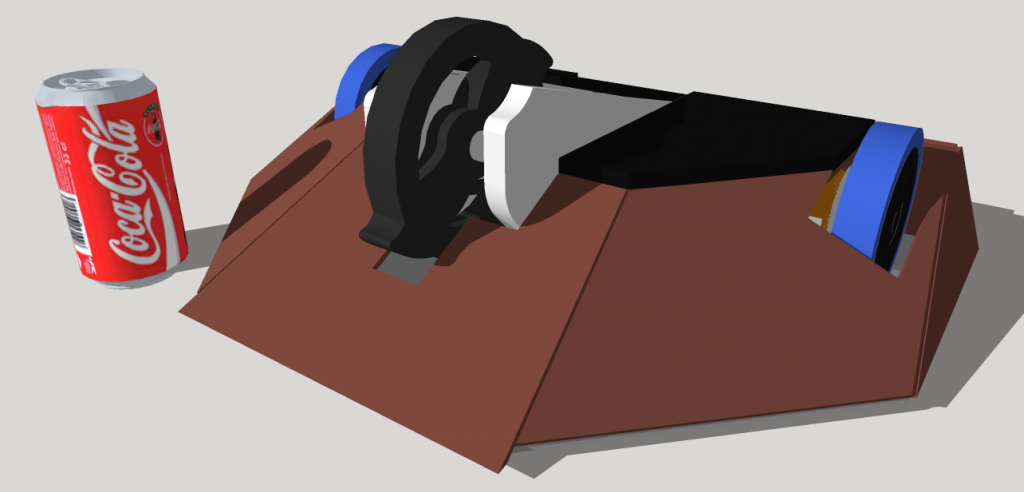

    • Loving that Sketchup model looks exactly how i pictured it would when you were talking about it at the champs, if you get this all working how you want i can see it being a properly good machine, tough as a brick, powerful drive and that disc on the front. Man stay away from Hatchet!
      • Yeah, 8S. Managed to shoehorn one of these into the back. You'd probably only get one fight out of it, but 8S batteries are big, and space was a concern. On 8S and 2:1 the disc speed is ~12,000rpm, and on that 150mm diameter disc tooth speed is ~215mph. That plus the wedge underneath means big hits every time. Disc weight is about 1.2kg. Weight-wise, I made a calculation error and factored in the weapon ESC twice, so realistically weight is about 12.8kg. And that's with basically the same shape as HWII, but half the thickness (all the way around) with 10mm HDPE instead of the stainless. Baseplate is also stainless, 3mm, which is 0.5mm thicker than the stainless base on HWII I believe. Put magnets in and it'd make for one heavy hitter! Drive-wise, this is the one being used, and if anyone else wants to use them I can upload the model to the workshop. On 5:1 top speed is as Matt said, 21mph. I reckon gearing down a little more for a bit more control and torque is a good idea, maybe just to 6:1. So yeah, should be a total brick with a hard hitting weapon and decent rambot drive as a plan B. What's not to love ?
        • It looks just like I imagined it too. Space is going to be tight but I guess you are used to that.

          • Thought of how I can do scale in Sketchup
            • Aye, definitely Nick! Looking at different options still to see what'll be the best, maybe a 2/3-stage with faster motors would be better, but I'd just worry about space. Still, that's what designing's for I guess! I'm probably going to limit the output on the transmitter side, 2kw is a lot for drive, it's nice to have but I have a feeling it'll not be quite as controllable as I'd like. Still, if I can put that power down on a run up, that's going to leave a very nice bite, and should have plenty enough torque to push things about if needs be, or at least it will in theory. At least I'll have the magnets to help that out! It's nice to have that extra power there though as a 'if worst comes to worst' type thing, since I really don't know how it'll perform in practice!
              Sam, it looks awesome doesn't it? Jarvis has done a heck of a job! Hopefully too, would like it to be able to cause a little more damage and carnage next year! Hardwired 2 will still be the relentless brick of the two, I fully intend to make that 100% reliable and indestructible but I think HardWired 3 will become my main competition machine. I'm actually looking into making both machines run the same internals so that I can perform an easy switch in case there's an issue, but I'm not too sure yet.

                And Jarvis, that Cola can should be underneath that disc - I'm a Pepsi fan Very cool though for seeing the scale of it all, looks pretty small with a cola can next to it!

                    Also, I think 8s is way overkill. You really don't need a motor capable of putting out 4000w (!) to spin a 1.2kg disc. I have about 1500w (about 3:1) on tap and it spins my little 1.8kg drum to 10,000 as fast as I can move the stick. 720 is also on just 5s.
                    2 teeth on a 12,000rpm disc, at an unrealistic-for-the-maths 10mph collision speed and allowing for real life, you can hope for at maximum about 6mm of bite, which is really not a lot for a best-case. A single tooth will help that of course.
                    Hardox front end may actually be more trouble than it's worth next year. Takes one hit from any vert worth its stuff to bend 3.2mm and barely slow down now. You may do better to have something cheap and replaceable that can be bent back at an event or just replaced when it's too mangled. Saves weight too.
                    I'd focus on making the core of the bot (inner bulkheads, weapon shaft setup, structural (back?) plates, etc) as strong as possible, which can be achieved by downsizing motors and LiPo to gain weight freedom. Could even get a heavier disc in there.

                      • Yeah, Optipowers are definitely going to be purchased for my machines from now on - they're very good! 8S may well be too, I agree but I'm aiming for OTT power, maybe it's slightly the wrong approach but still. Was tempted actually to run a single tooth disc on a 1:1 ratio from the motor, but I don't know if that'd be a little too fast... Hopefully the torque behind it would mean it'd just carry on going after a hit rather than slowing down, which is what I was aiming for with that motor in particular. Probably don't need something that powerful, but I want to try and push the boundaries a little!
                        Plan is to go with a single-tooth at some point, with most of the weight on the edge, should be fun! I'd like to aim for 20mm of bite on the disc, again ambitious but it gives a goal to work to. Yeah, I agree with the Hardox sentiment, however there are potential improvements to be made to it in the form of higher grade armour or whatever. Failing that, thicker titanium could work... I suppose it depends on angles though, they're pretty handy on HardWired at the minute, any high risk areas could have extra panels on, or maybe even use HDPE over the top like Explosion does.
                        There's always refinement to be done, but it'll get there. Research into new types of armour could work too, I have a few ideas and I've been listening to other peoples' for inspiration so could have something even nicer for armour when if gets built!
                        • The kinetic energy of a spinning weapon increases with the square of the rpm, so a single tooth disk at a 1:1 reduction should have 4X the energy and at least theoretically the same amount of bite as a two tooth disk with a 2:1 reduction. Please chose option B so the rest of us have a chance
