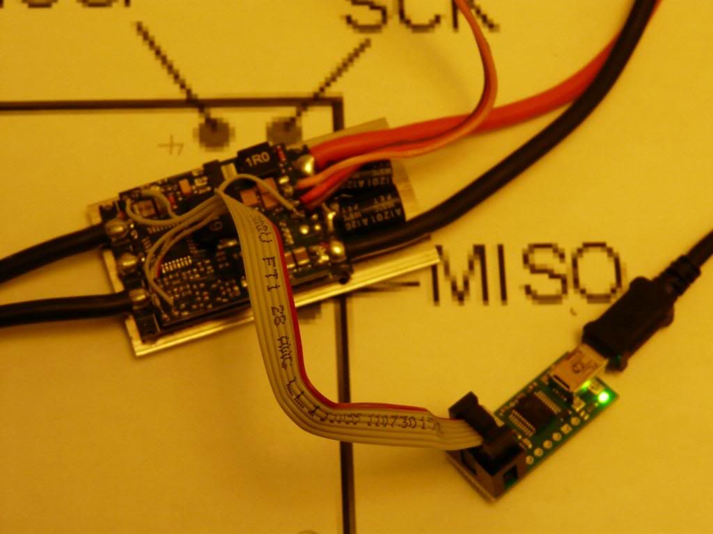

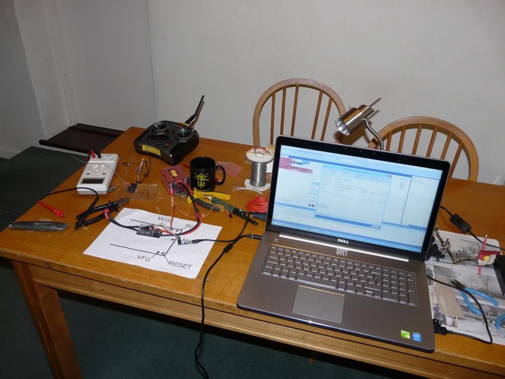

        Re-programming complete!
        After finally getting my butt into gear and ordering the Pololu programmer, which arrived very promptly, we were finally in a position to start programing. It was actually surprisingly easy to do, even the soldering was straight forward and I have to say, I take my hat of to all involved in writing the program, it works perfectly! The only difficulty we had was changing over the wire port to the motor, we managed it in the end nut it was a bit of a pain. So now, hopefully...again, Endeavour will be running at full wack A few pics of the programing process for those interested:

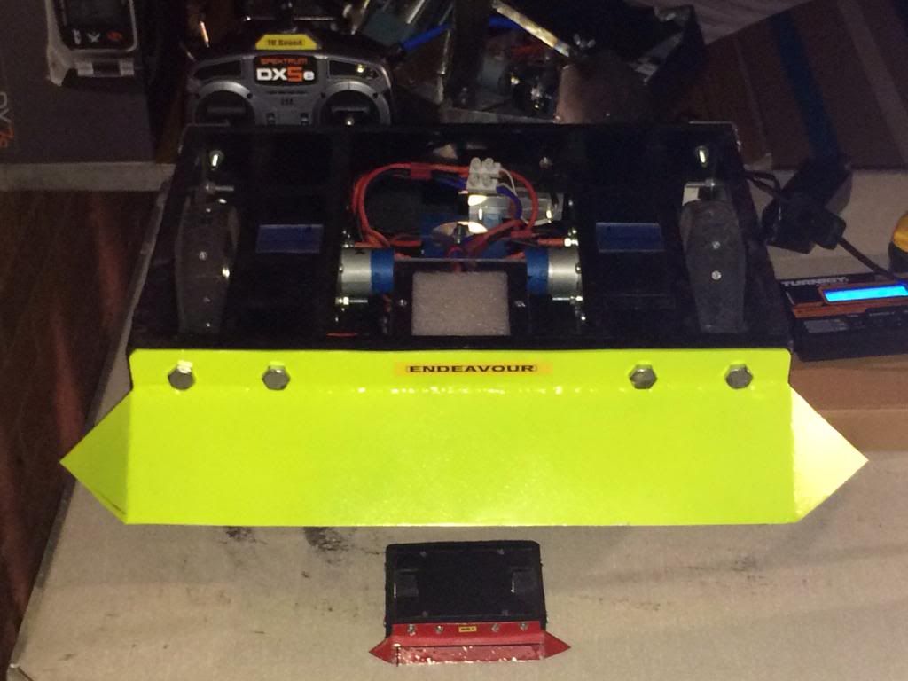

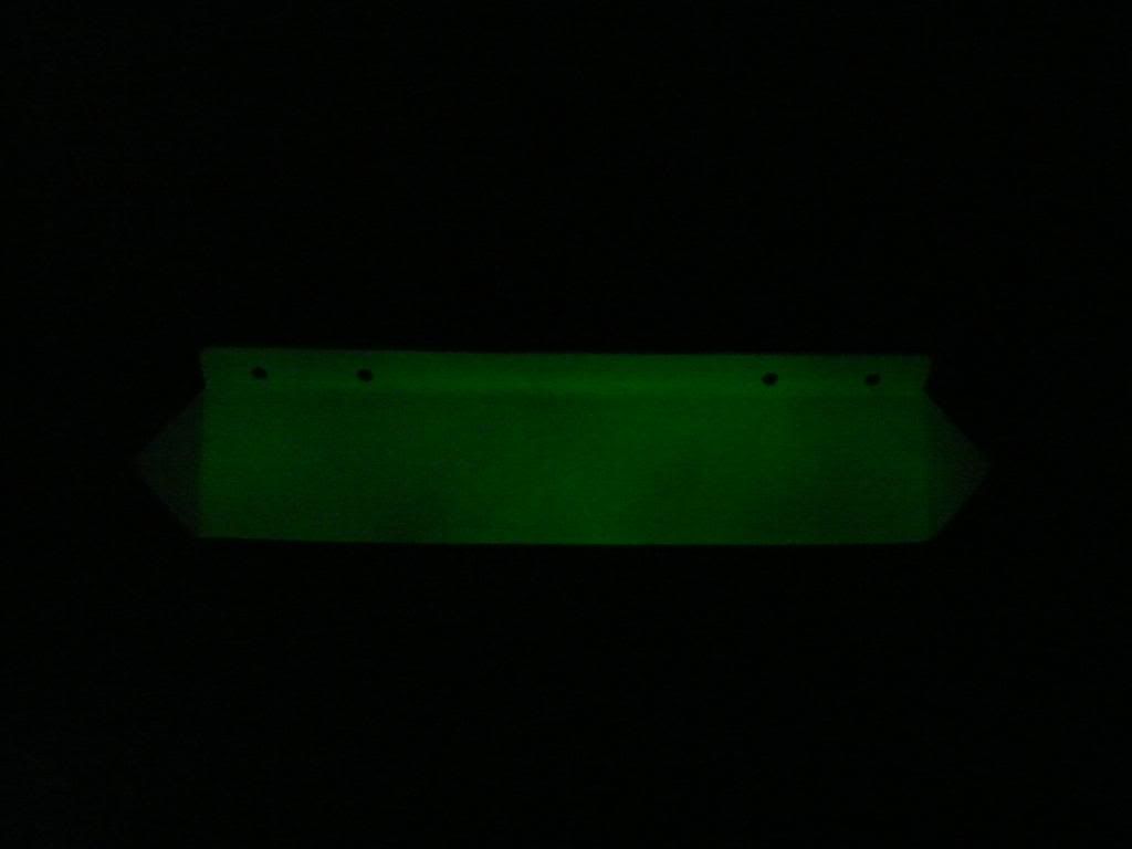

          We also repainted the scoop, and whilst it didn't last long, it did look quite funky before it got in the arena. We painted it a florescent yellow that glowed in the dark:
          Yer
          We have also finished the work on moving the link back which should stop the dam thing from falling out. Got a bit of another upgrade coming for Endeavour in the form of Hardox Corners (as opposed to the old Aluminium) which should be ready for the champs.
