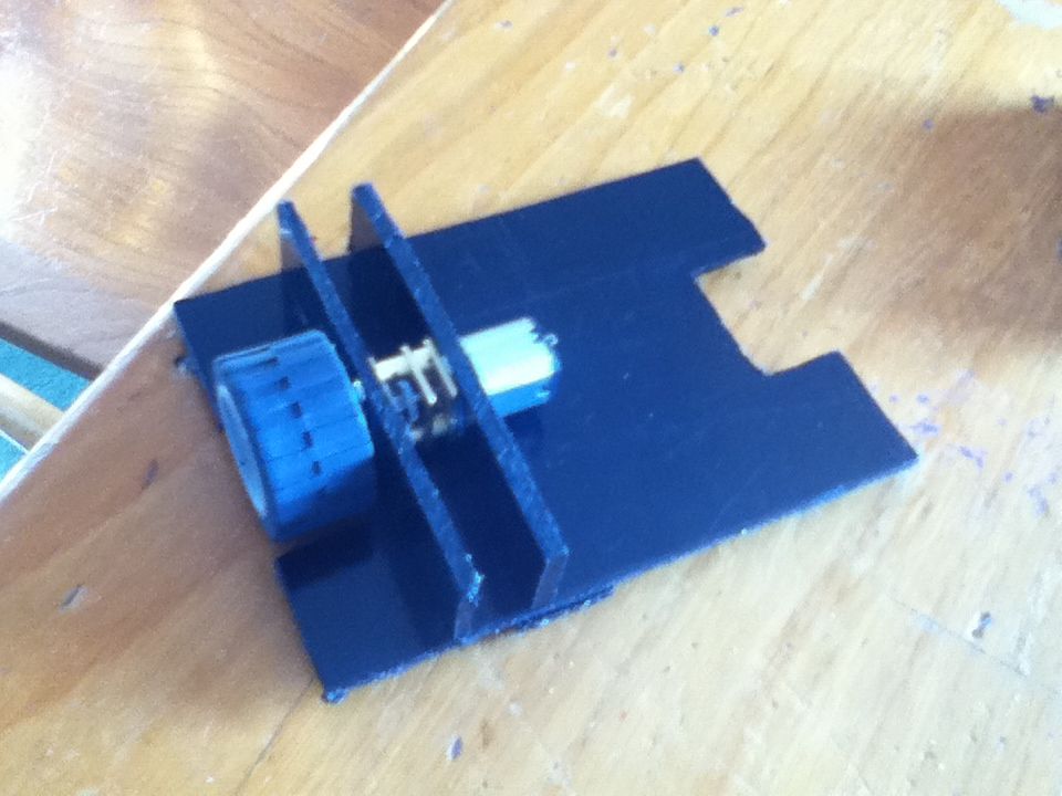

I have also done a bit of practising on welding HDPE with a soldering and I am quite impressed with the results
PS: Sorry for the dodgy photo quality, the house hold camera appears to be full of pictures and flat so I had to use my iPod

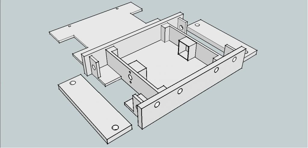

Ok then, so after finding that we are unable to be precise enough to make a AW by hand, I have decided to take a different approach... 3D printing
The cost for this beauty is 45 euro's, not too bad. Just need to run a few final checks and it should be ready to print

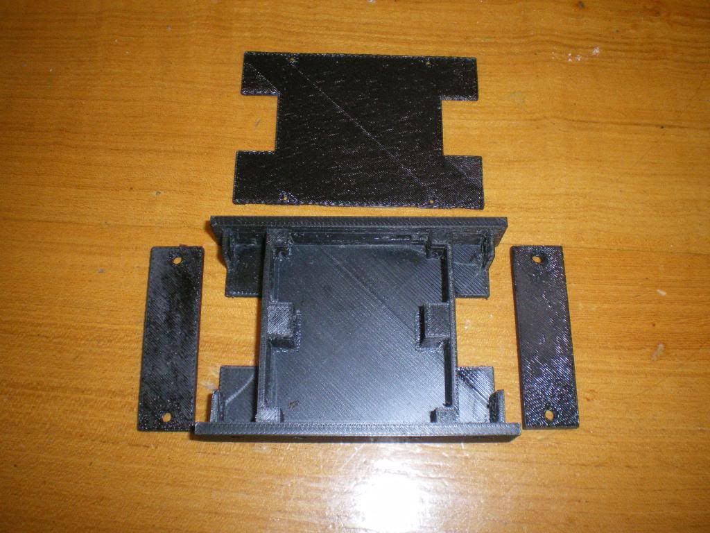

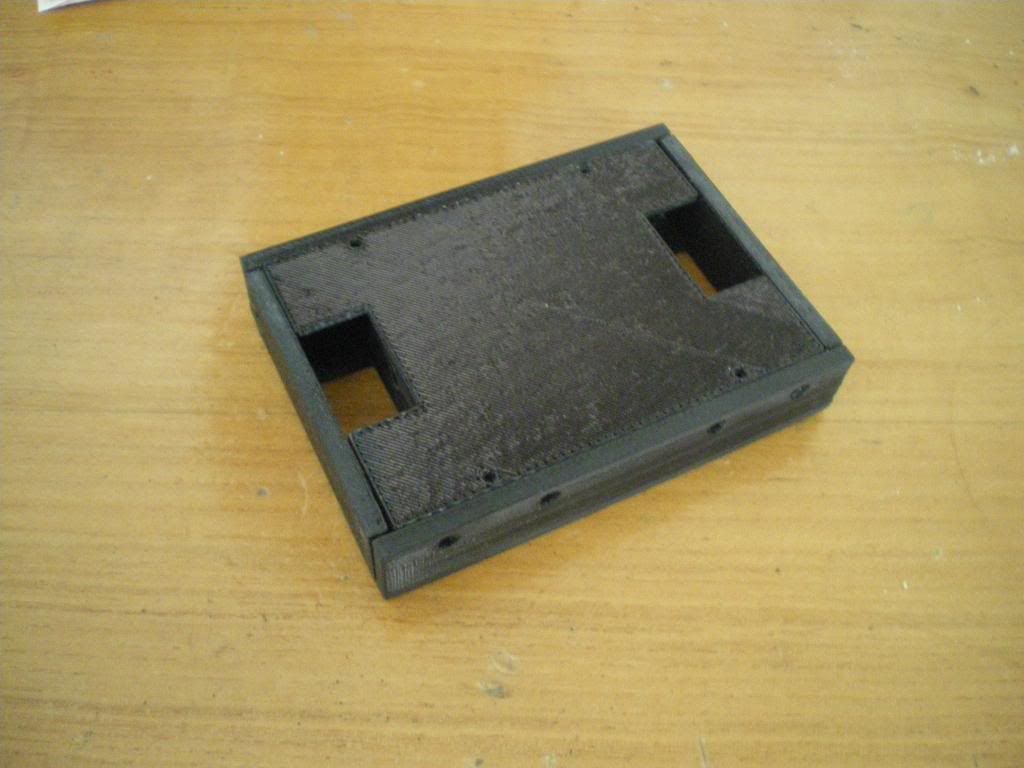

So, I decided to go with Pin Point for printing the chassis... and by god, what an excellent job Alex has done.
Here it is:
Held together by gravity

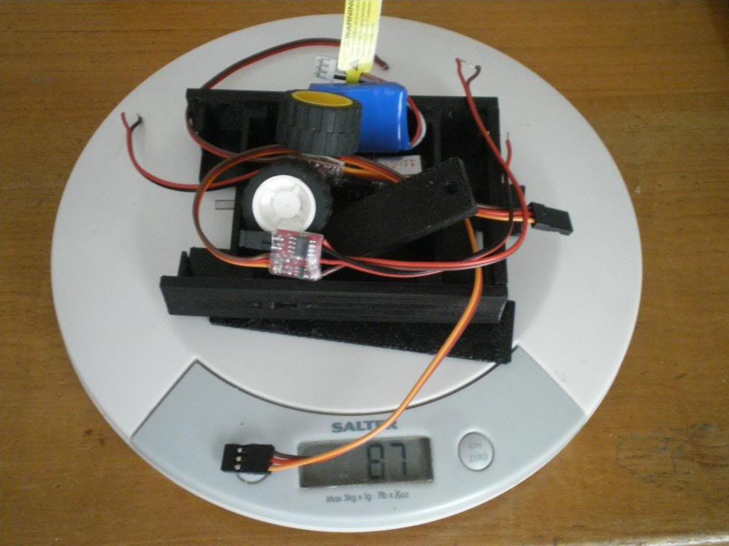

On the scales:
Seeing as it only weighs only 87g
, I can start to investigate into a beefy scoop. I think that titanium is probably best for this. What thickness would people recommend for spinner defence (I'm guessing something like 0.8mm to 1mm), and do any of you have any off cuts that they wouldn't mind selling us?

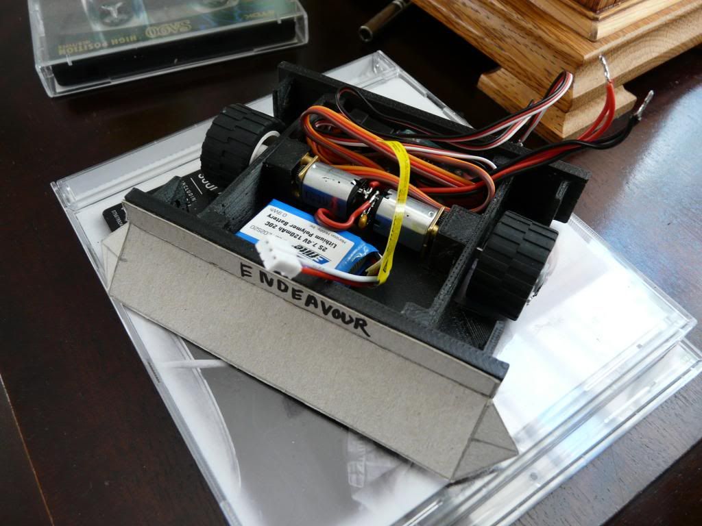

Made some progress on Mini E today:
Soldered capacitors to the motors as well as the ESC's. Connected it up to a bench power supply and tested it to see if it works, and indeed it does. I've got a few more bits and bobs to order until I can make anymore progress (duff: did you get our PM?).
