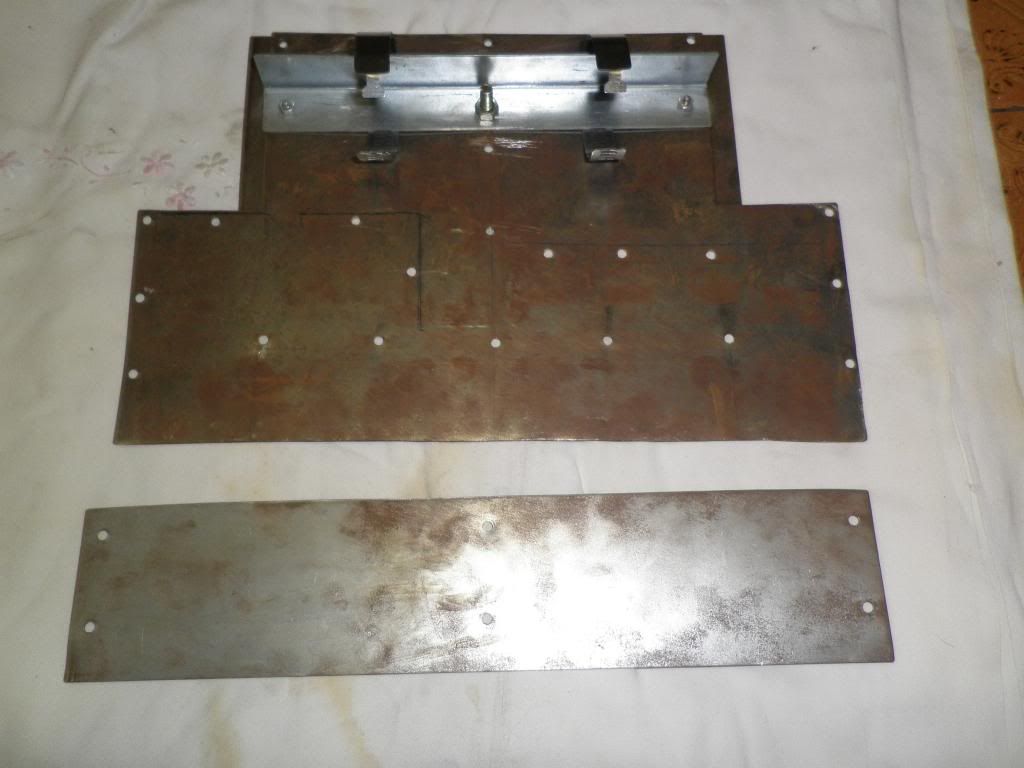

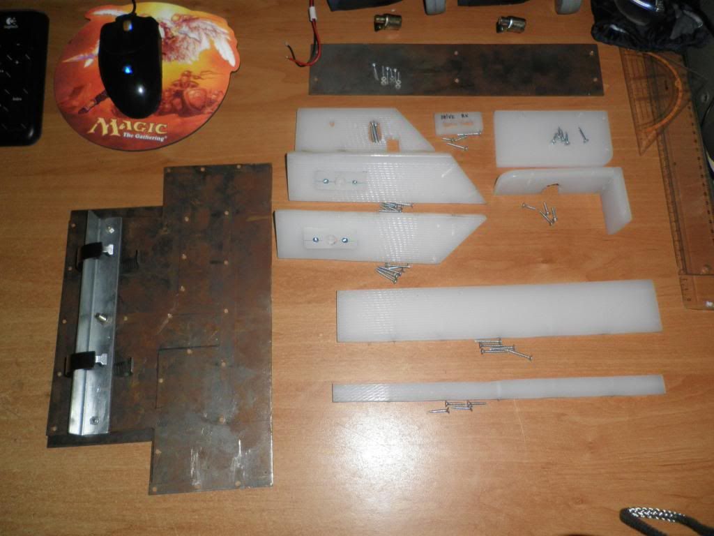

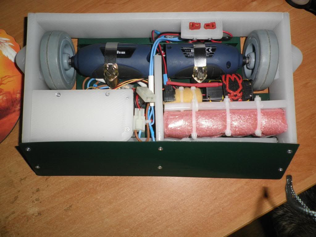

        After almost one hour, 50 screws and an hell of a pain on my hand/wirst, Primogenito is finnaly fully disassembled so i can paint the steel parts.
        Electronics:
        All body parts:

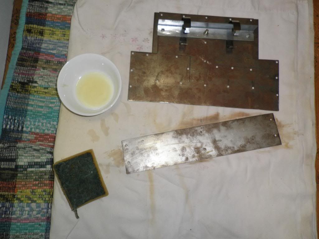

        Cleaned the rust with lemon juice (i don't have tools to unscrew the nuts at home):
        Tomorrow at the workshop i will sand every thing and paint it. I am undecided between black or dark green, what do you think would go better along with the white HDPE?
        The gears on the first stage of my planetary gearboxes is plastic, so i will see if the metal gears from an old drill are the same size so i can replace them.

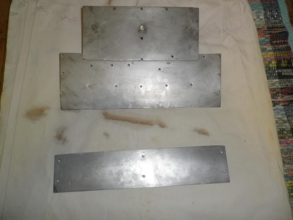

            Metal parts all painted, phase one completed. And i also discovered that using relays and servo electronics Primogenito actually as some speed control.

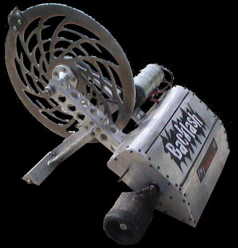

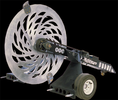

            I found some old motor on my garage: 2 drill motors, 2 wiper motors, a wiper motor without the gearbox, a really big 24v wiper motor from a truck and a 24v 250w scooter motor. I am thinking about building a Backlash/Nightmare FW replica. The scooter motor to power the disk and for the drive the drill motors or the wiper motors, but i will leave that for after i finnish Primogenito.
            Backlash v5
            Nightmare v4

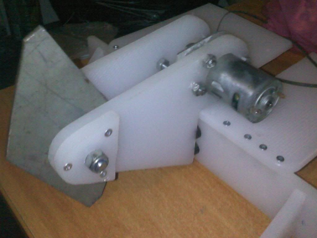

              So, i spent the last days/week building a weapon for primogenito, every thing was going fine until today.

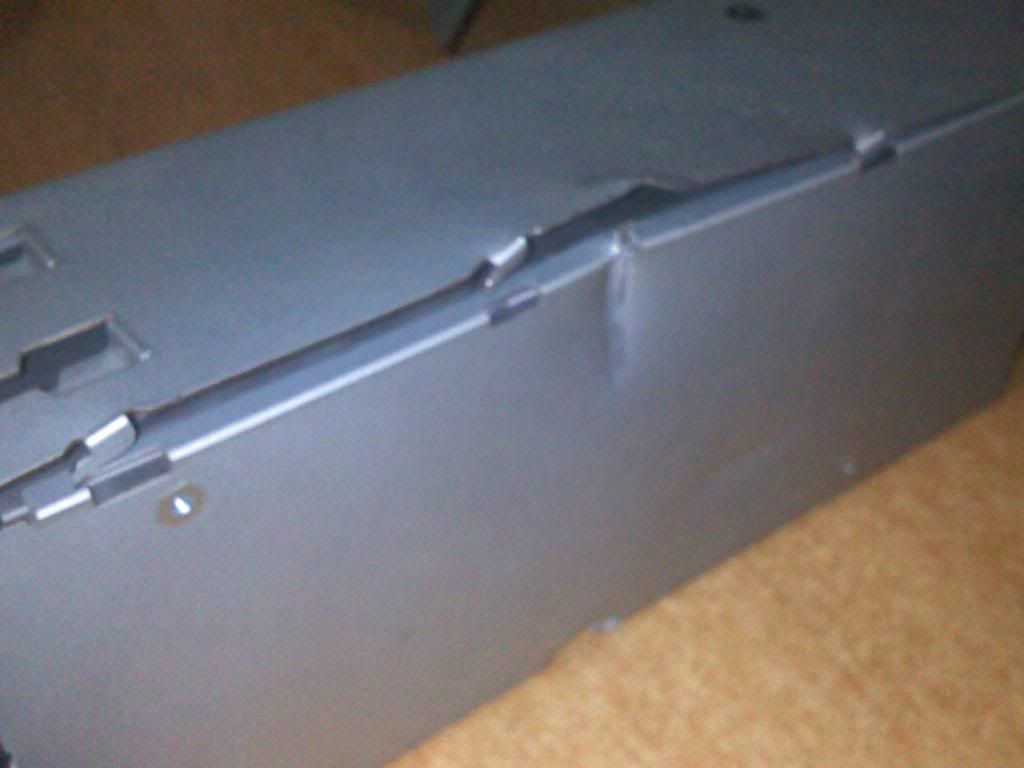

              I had already tested it, but today i wanted to test it at full power (18v) against a 2kg 1mm steel power supply. The PSU had no chance, it just flew ~1.5,meters, but the belt snaped in two and pulleys broke.
              But that's what you get when you used the wrong materials. One more lesson to me at least.
              Now i have to think about how i will make the new weapon, a properlly made one this time.

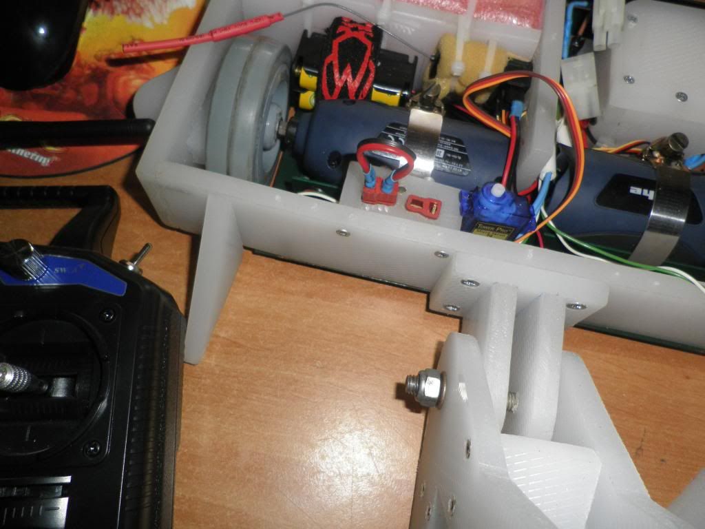

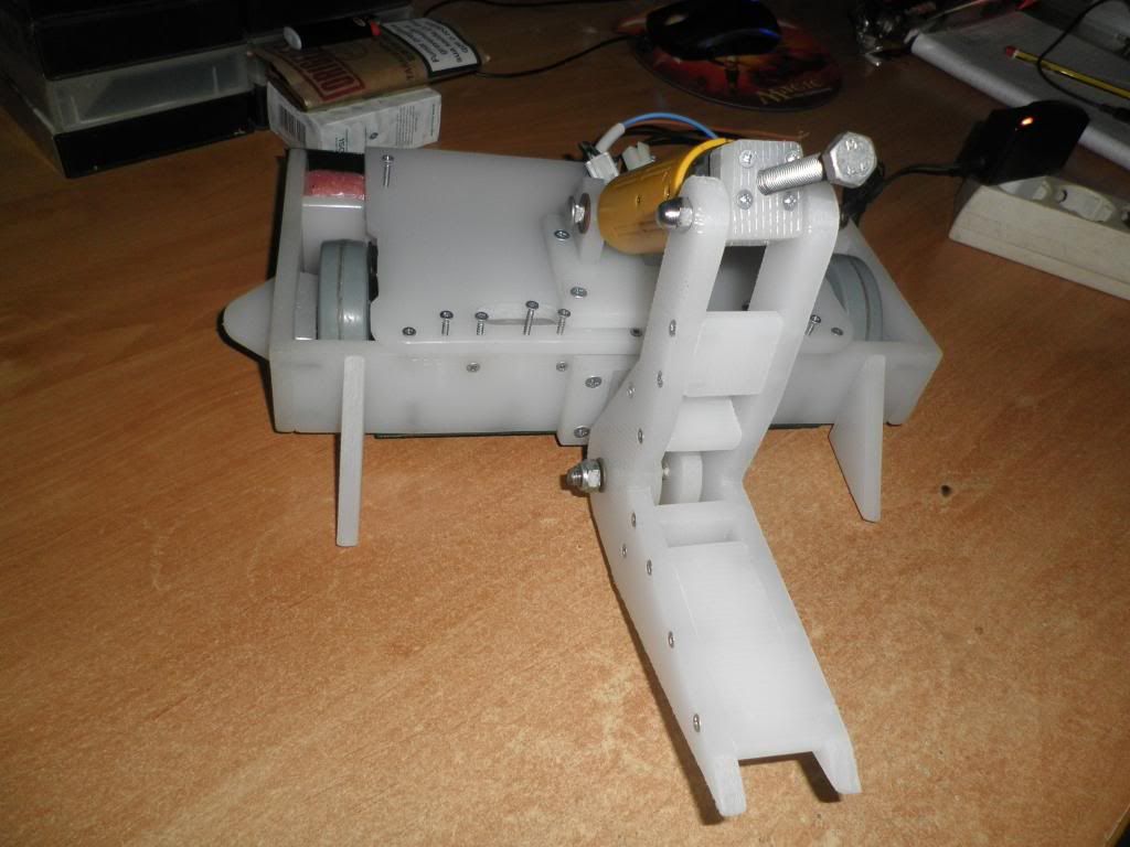

                Some advances on the lifter:
                I use a screwdriver to power it, but it's a 3 stage reduction instead of 2 stage one, full metal gearing.
                Overvolted from 6v to 7.2v.
                Only tested it at 4.8v and it could lift 3kg no problem, at 7.2v it surely will lift much more. Can i use a scale to see the max it will lift?

                  Armor and cosmetics are not important, but i have to build the control system for the lifter to make the demo. So, to do list: order a servo, UBEC and two relays; build control system; new wiring to handle a third motor.

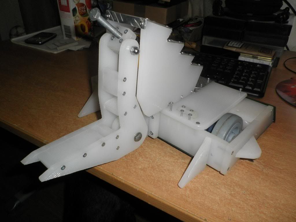

                        Some work done this weekend.

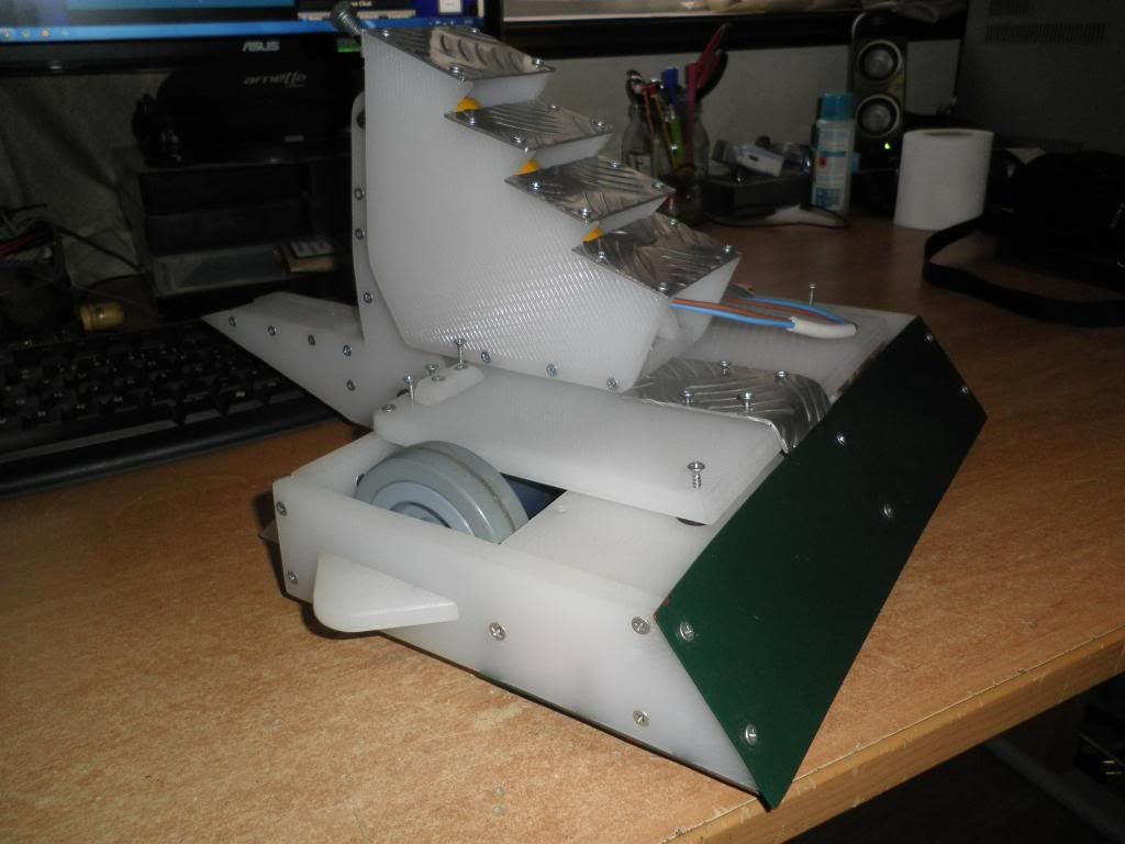

                                Just got my order, an UBEC, micro servo to make the lifter controller and some connectors.
                                Also started to take Primogenito apart to make the upgrades.
                                Will update the thread later or during the weekend.
