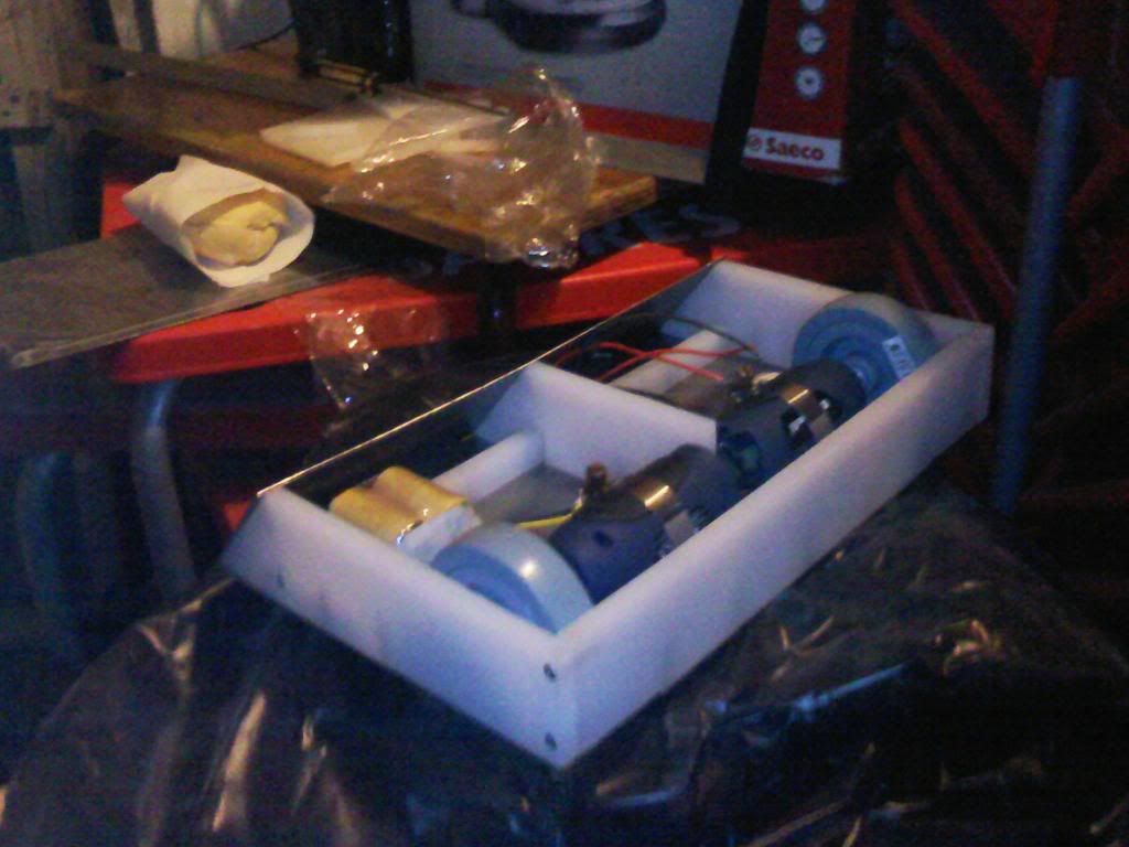

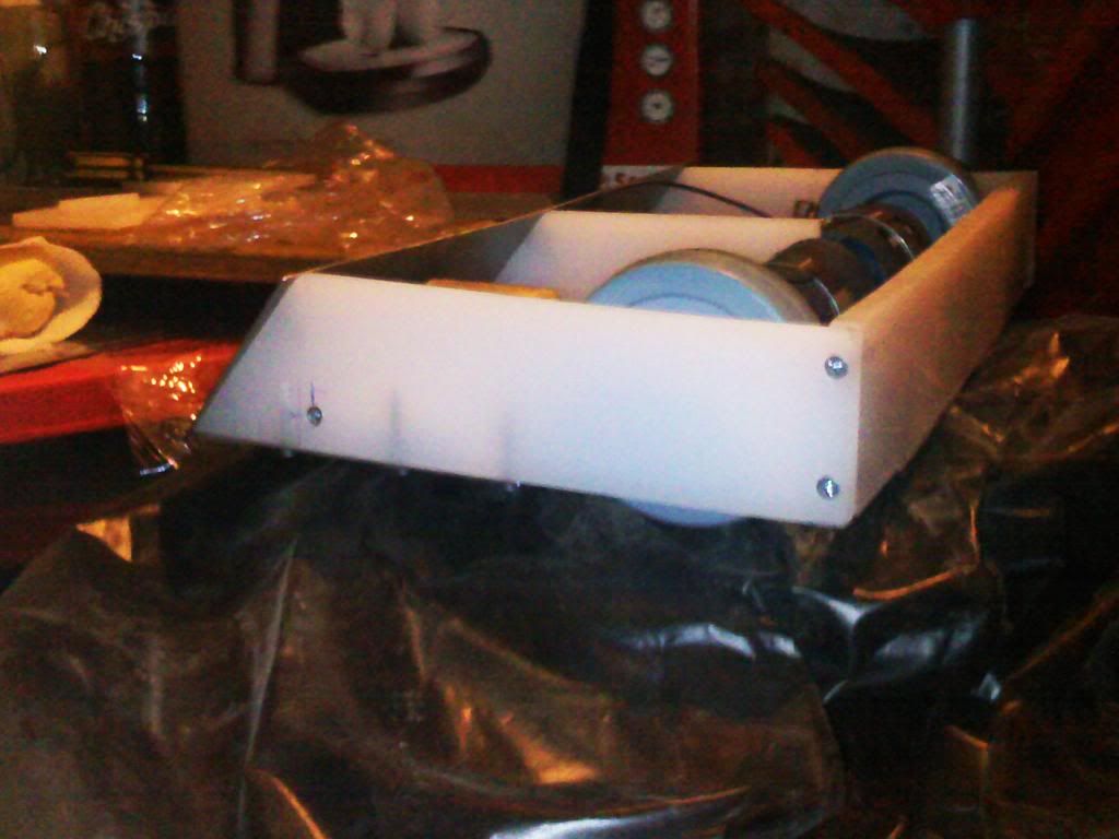

    Body build day 3:
    Now this is starting to look like a combat robot!
    (Don't mind the sandwich, working makes me hungry )

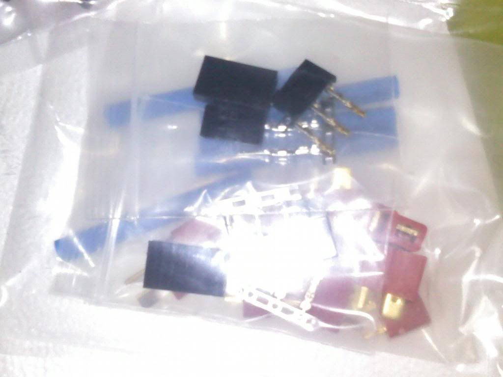

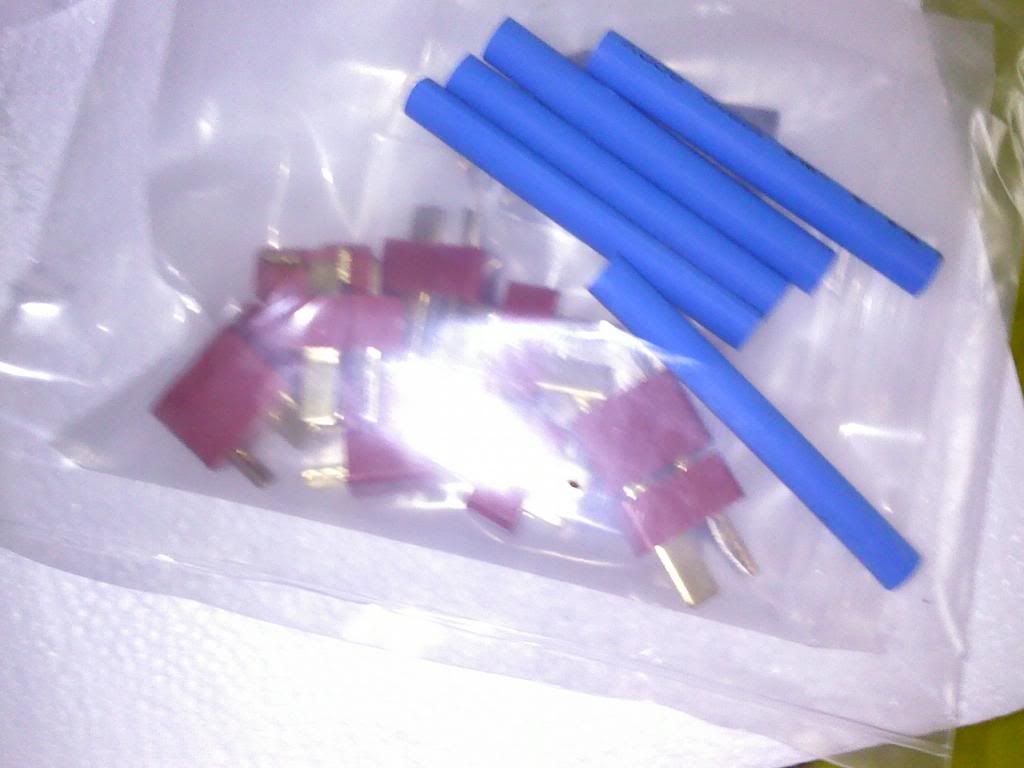

      I received my package today, just 1 day after making the order!
      6ch 2,4Ghz FlySky Radio System, 5 Deans Ultra Plugs and some Futaba connectors.

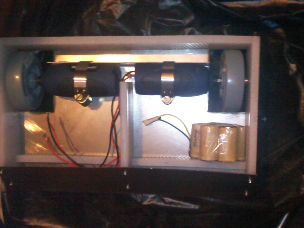

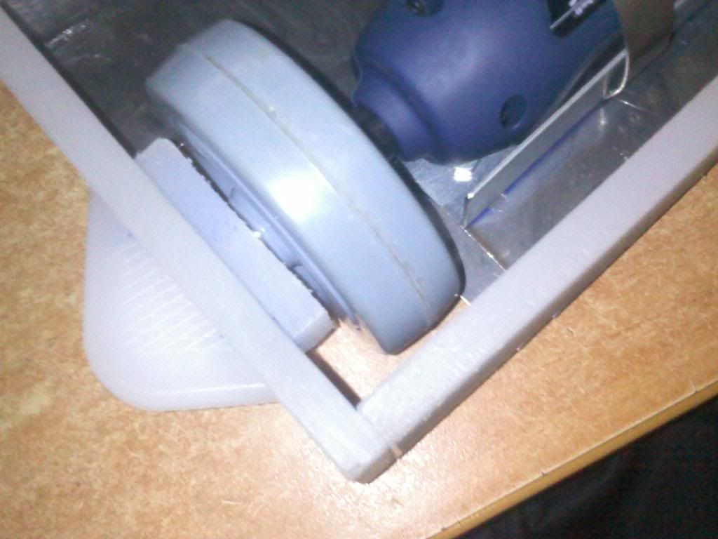

      Yesterday i worked a little more on the robot body, i made 2 axel supports and added 1 triangle on each side so the robot doesn't get stuck if it lands on its side.

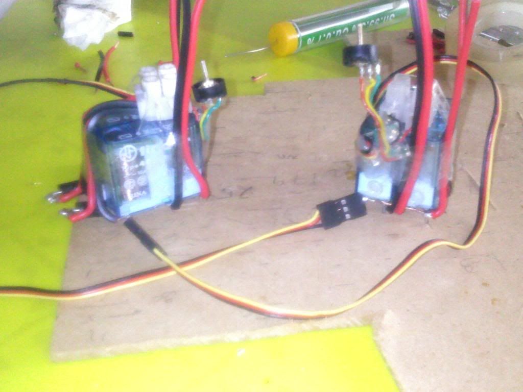

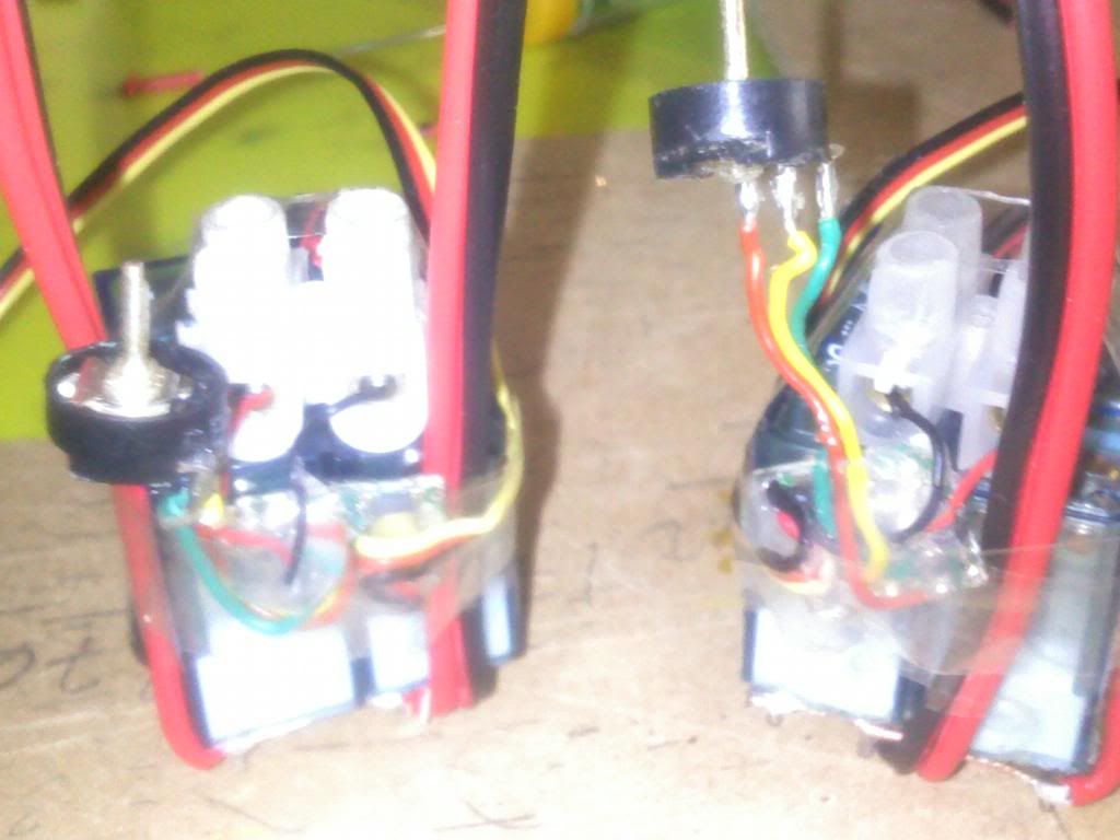

        Radio system tested and every thing appears to be good, still have to try the software to program the TX from the computer (elevon mixing to control the robot with just one stick).

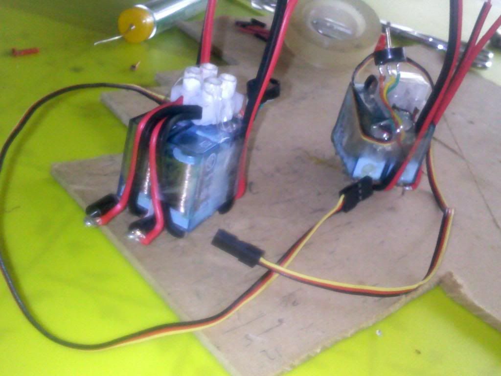

        I also finished building the H-Bridges, they don't look very good but they work great. I have to find a small plastic box to put them in.
        (The two relays at the right are old ones, 5/6 years old, i was a kid and didn't know how to properly solder )

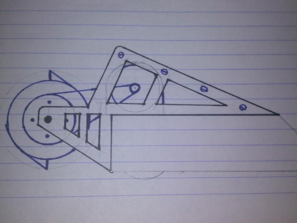

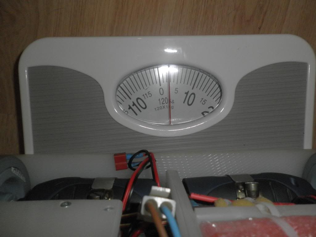

        The robot weights around 2.2kg with the batteries and all the electronics. It can't be a beetle but i will make it an mantisweight with active weapon. Now i can because of the 6ch radio. But i will leave that for a near future, now i have to save money to buy two 6/7.2V batteries and a proper charger.
        I have a 550 motor from a broken 12/18V drill, i am thinking of using it to power a vertical spinning bar/disk.
        Maybe something like this:
        (I know the disk teeth are wrong )

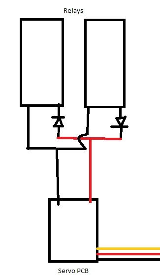

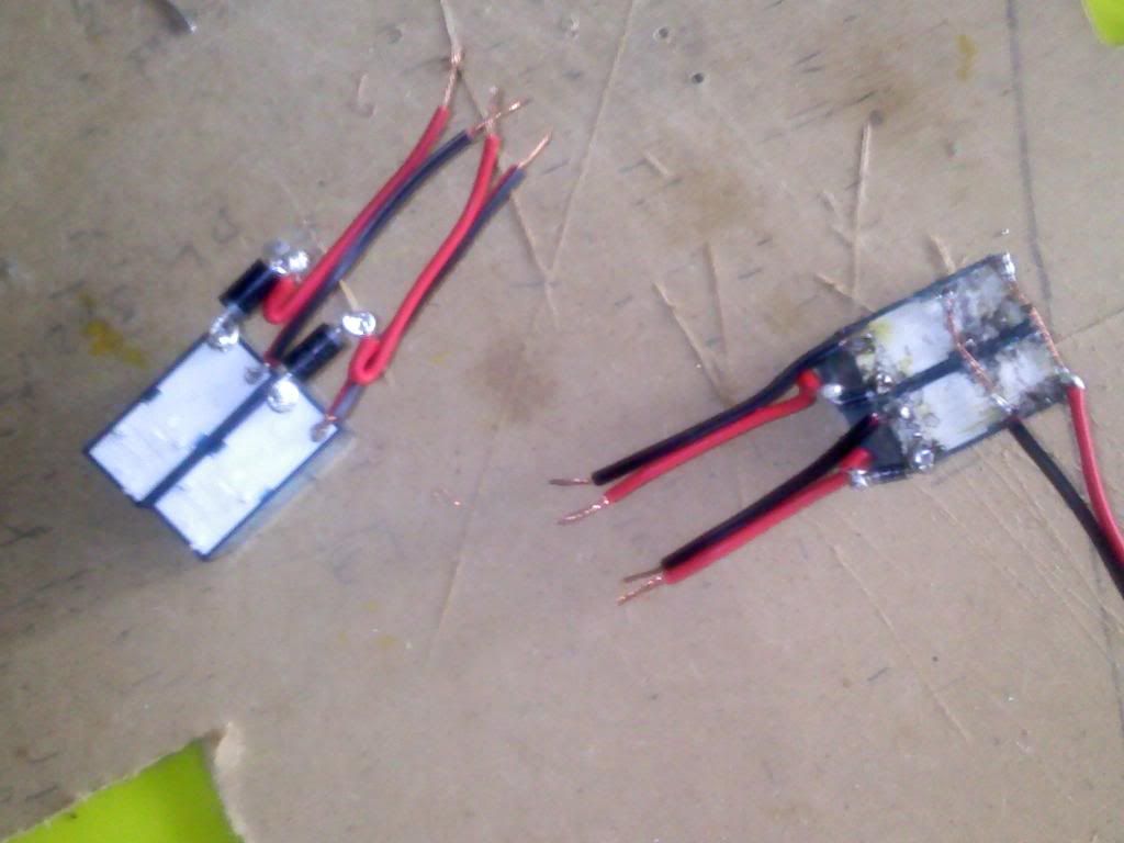

          So, i forgot that i should put a protective diode on my relays coils to protect the servo pcb/receiver.
          My circuits look like these, how should i install the diodes? Any help? I don't want to destroy my receiver.
          (It was drawn very quickly on paint)
          • #35
            Re: Build Diary and some questions that may appear - BW/MW
            Reverse bias parallel to the coils (backwards across the coils)
            • #36
              Like this?
              The two relays are connect to a servo pcb, instead of the servo motor, and the two wires change polarity. Will the pcb/receiver be protected this way?
              I have seen some people from RC forums doing this exact same schematic (without the protection diodes on the coils) without any problems. May be the protection diode only works/is requiered when using microprocessors and such? I don't see how the diode will protect the pcb on a changing polarity circuit like this...

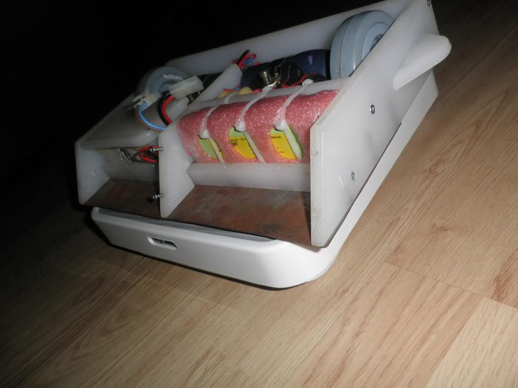

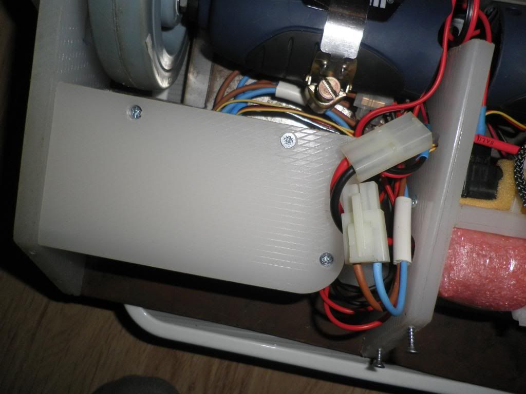

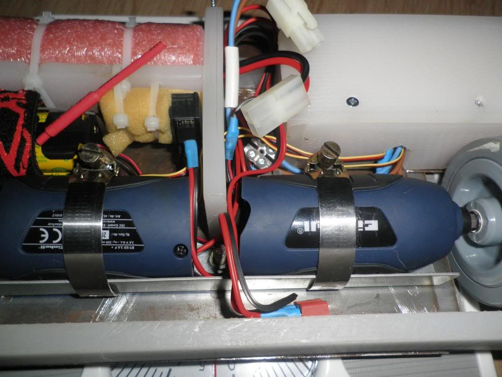

                      Phase one at 95%!
                      Primogenito is as compact as it could be, it was almost impossible to fit the receiver batteries. I am considering making a BEC so i only use the main battery and it's much smaller than 4AA batteries. What amperage you guys think i should chose on a voltage regulater to build the BEC? 1, 2 or 3amps?
                      Just need to make the main battery removable link, program the elevon mising and sand/paint the steel bottom and wedge (their surface is rusting pretty bad).
                      My father showed me a trick to remove rust using lemon juice, but i will sand the metal so that the paint will adhere better.
                      I was going to make a small test drive video, but batteries only come with a little charge and it died on me...
                      I will leave you with some photos (this time they were taken with a digital camera ):

                        Just buy a BEC, the are only £15 or so and will be much more reliable than a custom one.
                        Great machine though. Very, very tight!
