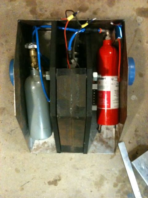

Tested the pneumatic system again- it went badly!
I had the system piped up and turned on the co2 from a paintball bottle, I had the nut on the regulator fully undone then I screwed it up, it was at 2 bar and I tried firing the ram but it didn't have enough power. So I turned the regulator nut a little bit more then the prv (10 bar) fired and all the co2 came out. On my pressure gauge it went further than it measures. The pvr was covered in frost and the bottle froze to the ground. There was a lot of pressure when the pvr went off.
Is my Trevor regulator Brocken?
