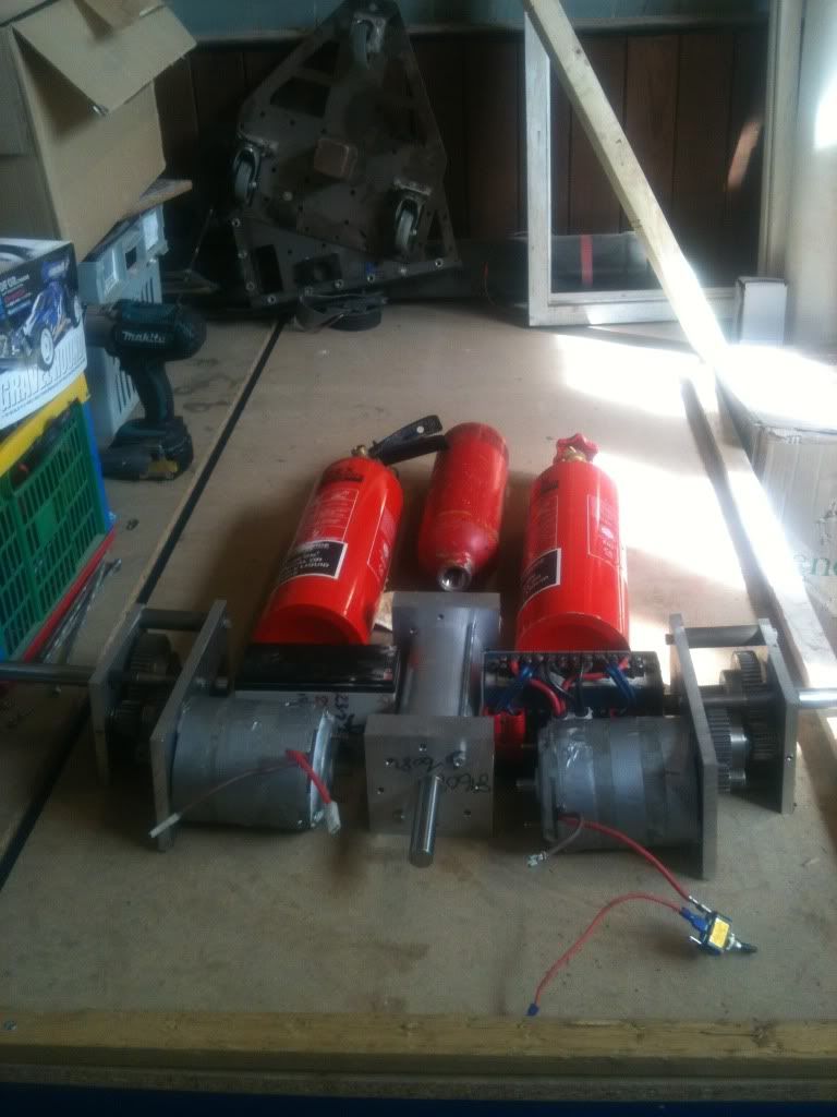

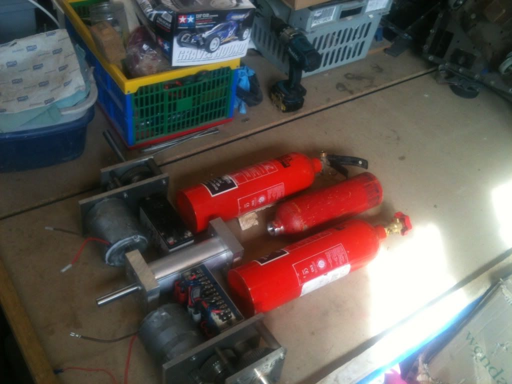

Thanks, output shaft is 20mm stainless steel rod- I think I will have to support it at the far end but not sure what wheels I'm using yet so if I don't use much of the shaft then I may get away with it.

I hope so as my dump valve is essentially a safety/pressure release valve, operated by a cable. I think it should be fine as long as I dont get my hands inside the robot or remove any access panels.Originally posted by Max View PostJust wondering, is it acceptable to have a mechanical linkage to activate the dump valve? Eg. You have to pull on a piece of wire to open the dump valve? Or pull on a lever connected with linkages?
The problem is as Mario says I can't afford loads of chargers to charge them all and they will take ages to charge I imagine, easier I imagine to do what the saint team does and just have a battery pack per fight. I am still considering hobbyking lipos, there a good price as long as I can charge the packs between fights as I can't afford more than one set of packs.
You're planning to run the Bosch 400's @12V. That gives you 2 realistic options for LiPo. 3S or 4S. (5S is 18.5V, right in the ballpark for "overvolting", but then the gearratio is a tad low). A 8000mah pack will probably see you trough a fight.
This means you need 1 Imax B6 AC , cost, less than £50 delivered at your door. And that one can charge the 4S 8000mah pack from "safely flat to full" in less than 2 hours.
Pricetag together, a tad more than 1 45Ah gelcel or AGM SLA without charger.
Difference in weight..... huge. 1 kg compared to 12 kg.

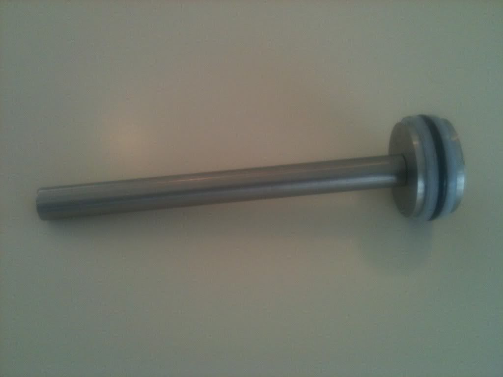

4 kg of CO2. That's 2000 liters of gas @1 bar @ roomtemperature. Your ram uses per stroke 27 liters. That means 60 strokes at least(not counting losses due liquid CO2 venting). In a 3 minute fight it's an action every 3 seconds (or 6 if it's double acting)
I would say, use only 1 main storage bottle if size is bothering you.
