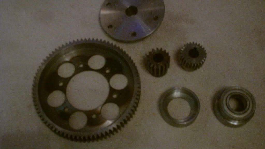

    And here's those pictures - good luck Shane, hope this goes well

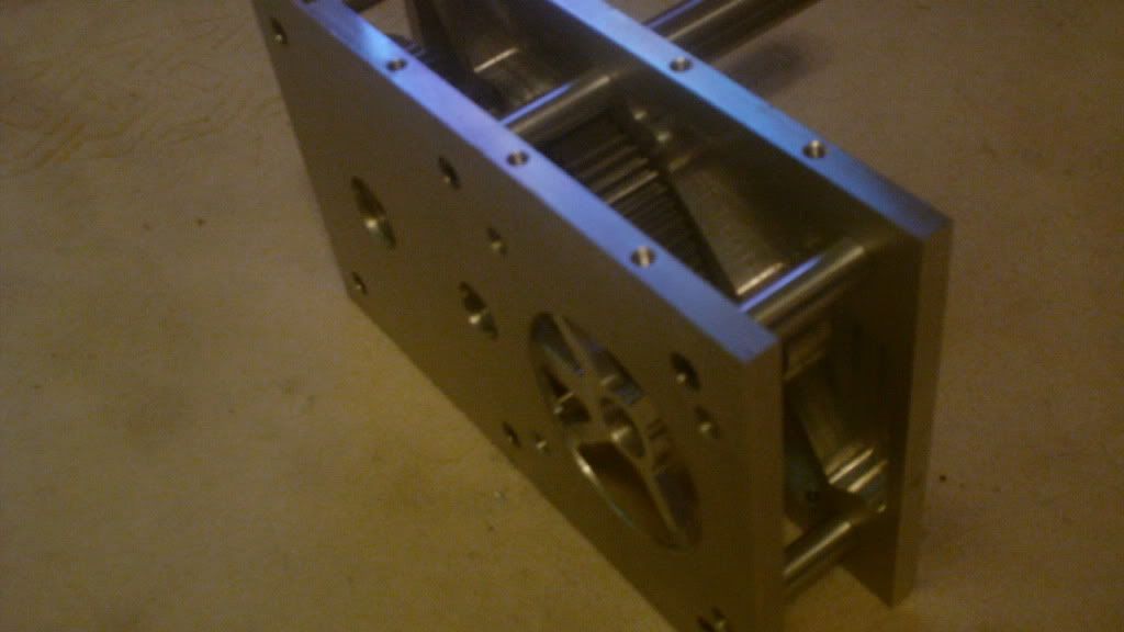

              More photos for Shane, looks like it's coming along nicely

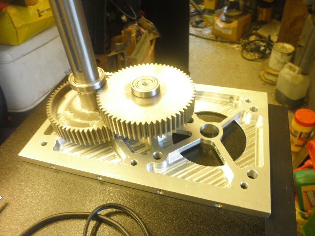

              These are the Lambert Powerdrive gearboxes, to quote Mr. Swan:
              Originally posted by swanaldo
              the gearboxs were made by the great Mike Lambert and similar gearbox were in his famous robot Dantomkia. Its a pleasure for Teambud to use The Lambert Powerdrive. they are custom made to my specs for Full Tilt
              Can't get better than that really

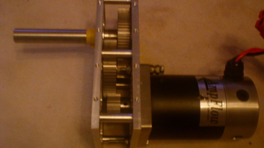

              The beginning of the weapon drive

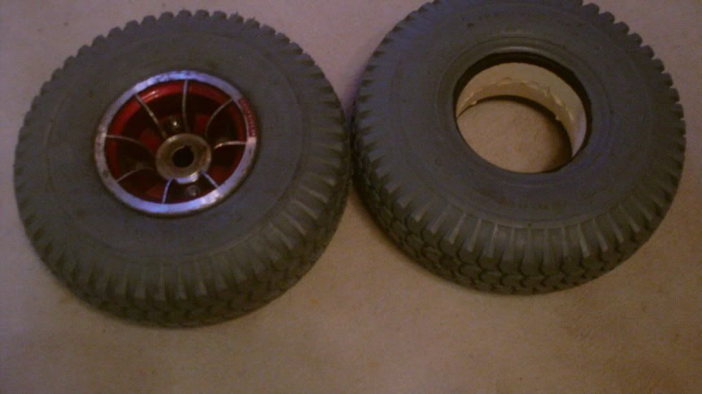

              Two of the 10 inch drive wheels

                Thanks Joey....Just a couple of pick of parts....build starts Wednesday. Will post pics for those interested.

                  Oh and before i get pointed out anymore...the motor gear is loose on and the bolts holding the motor on were all i had at work...just together for piccys.....
