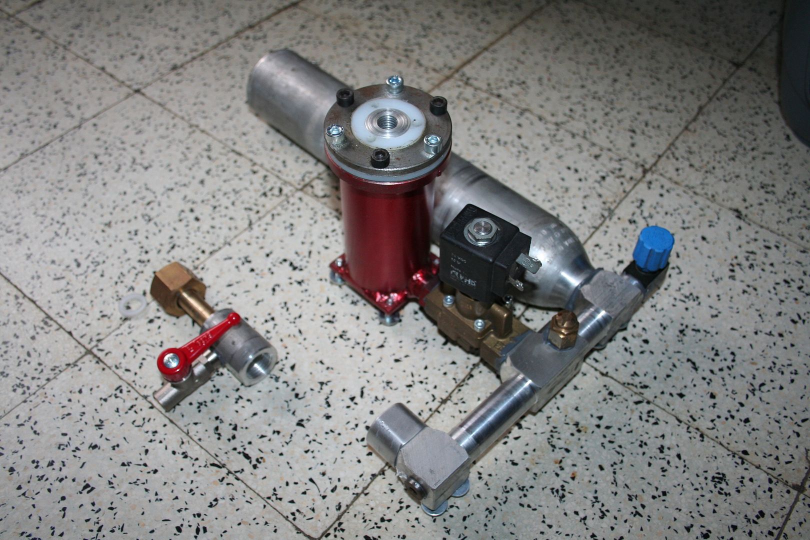

            • #51
              Re: Metalbeak (FW) Build Diary
              Finished pneumatics:
              • #52
                how much did that setup cost you?
                • #53
                  £297 for the whole thing.
                  • #54
                    whats the bore/stroke of the ram and the weight of the system?
                    • #55
                      The ram has a 50mm bore and a 100mm stroke, the weight of the system is about 6kg with my 20oz main tank.
