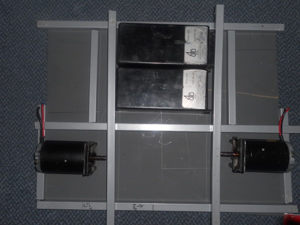

    frame layout:

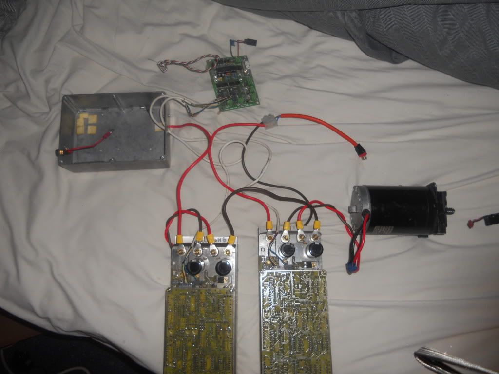

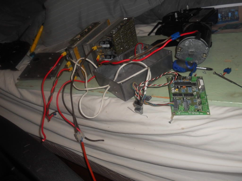

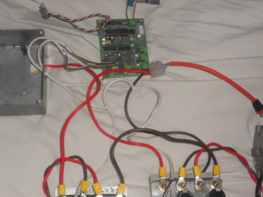

    with space for the 4QDs (which btw i am still fiddling around with trying to make work)
    the mass of electronics, think there might be a problem with the interface, it isn't lighting up when the 6v is put into it

      Hmm, the interface was lighting up and some lights were flashing when Jamie and I used them last, and we just copied Terry's diagram. I'm trying to think what to suggest.... Do you have any photos of it fully wired up? Might help to spot problems that way.
      • Re: team combat penguin build diarys
        ill have a go but apart from adding a female futaba lead to the screw terminals, i havent changed it atall.
          anything imediate that you can see is wrong?

              i mean with the escs :P

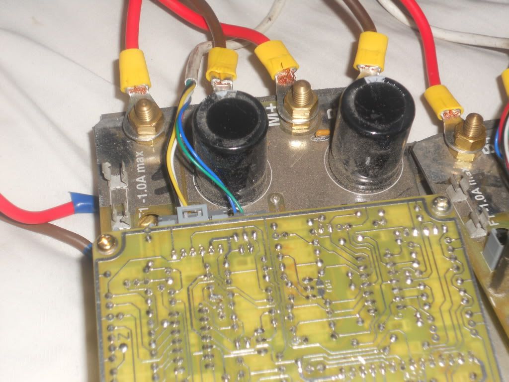

              kwik kwestion: where is the low voltage thingy on the 4qds, cant seem to find it

                What voltage you running your test on? I think I remember reading that they only work on 24 or 36v. Also you need to power the control board, 6v I think.

                    i was running 24v and using a 6v rx battery, i think the problem is that it might be set to the 36v mode, looked though the manual and it said how to do it, but i cant find the bit to do it on.

                      I see. maybe it needs to come apart to do that, a lot of the controls are in the sandwiched part so to speak.

                        makes sense. also, there is like a fuse holder on the escs, does there need to be a fuse in there for them to work?

                              You dont need a fuse, thats for if the fuse tracks blow. you dont switch them between 24/36v, they just work on either. I would suggest getting hold of a different interface, as that one (Ian Swann one) is no longer made, and you cant get the info on them. You can get a simple plug and play one from 4qd.
