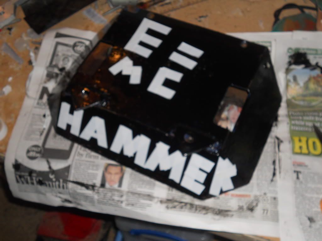

    painted and named
    • Re: team combat penguin build diarys
      I hope you put a sign on it when the paint was still drying. Something along the lines of 'Dooo-do-do-do. Do-do. Do-do CAN'T TOUCH THIS!'
        Haha, brilliant.
          i should have done that, ill h ave to put a sign on it at events
