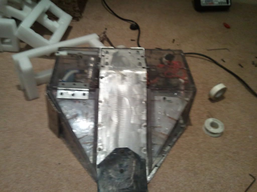

              Any pics of Eric Jr?
              • Re: Cicatrix Build Diary
                I'll take some PJ
                  Eric Jr:
                  I realise that it currently looks nothing like Eric, but thats where the Robo-Coat comes in
                    Cheers and no it doesn't!
                    Robo Coat?
                      I think it was a term Jamie coined, basically its a 6mm HDPE layer of armour that goes over the 10mm polycarb to make it a bit more spinner proof and can be easily removed to leave the polycarb for educational shows as it allows you to see inside at whats happening. I just need to get around a few problems with it, for example the door on the top right section that opens for putting the link in and turning the CO2 on/off, dump valve access etc. Obviously access is still needed to that section.
                        CO2! I want authentic Eric with hydraulics.
                          Eric might not even be hydraulic for much longer, haven't decided yet, I can't really do any work on any of them for the next 6 weeks anyway . Without the accumulator its gonna be a really slow lifter too.
                          Too heavy and expensive in a FW, the LP system has a good kick to it as it is, something like 120kg at the ram, and thats with no buffer tank. Will possibly add a long coil of tubing to act as a buffer tank instead as we'll be very close to the weight limit with this Robo-Coat as it is. 12.8kg just now I think.
