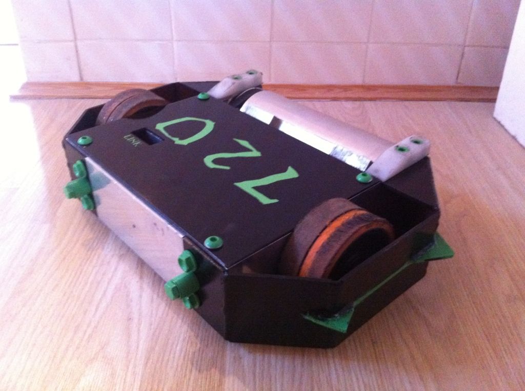

                • Re: 360 - mini hypnodisc
                  painted;
                  Just need to take it all apart, loctite it, fit new tyes as the old ones are a bit burnt out, then its done
                    like the paint job
                      Excellent work, it's got a Halloween feel
                        thanks guys over 30,000 views on this build diary now- crazy.
