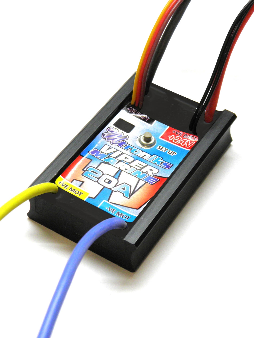

On the other side of the circuit board/casing, you’ll either have two wires coming out, or three wires.
If it’s two wires – it’s a brushed motor speed controller: http://www.mtroniks.net/images/XL/Marine20HV.jpg
