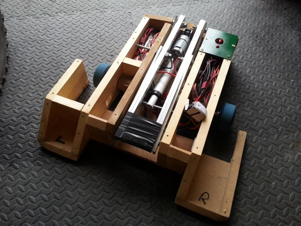

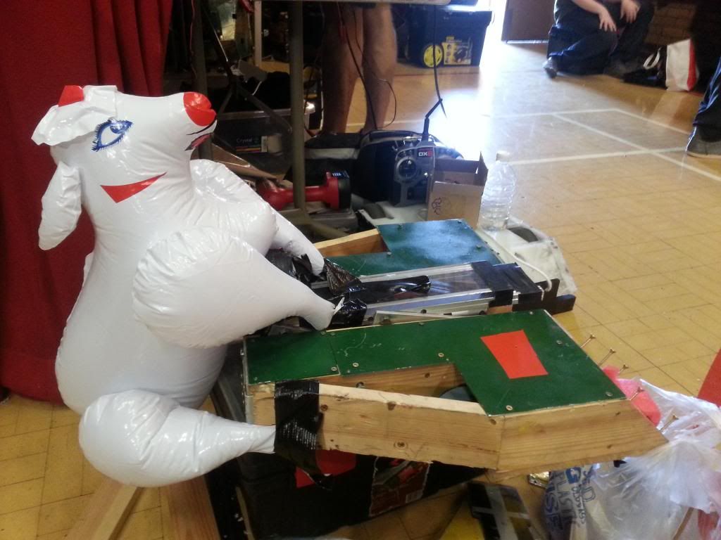

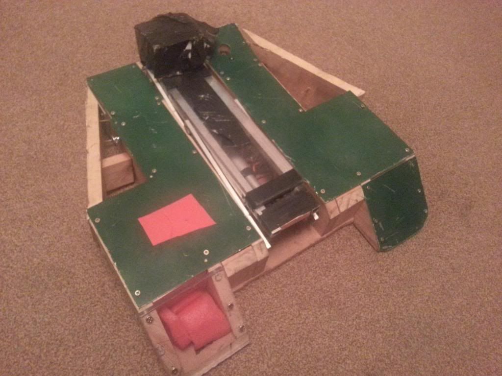

    My robot Loki has been/is currently made of wood although I have HDPE now and will be converting very soon. Here's some pictures, there's also some videos of it being tossed around the arena from Newport earlier this year.

        Thank you both loads and loads!!! Chris how did you find the wood stood up to a kicking? Is it MDF? I have next to know money so trying to cobble something together from what I can find lol.
