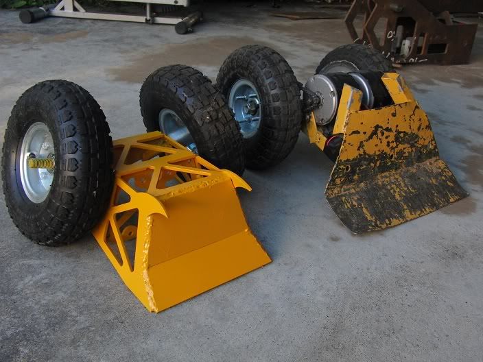

I've been using chain and sprocket reduction on my robot Vendetta for about 3 years. It has sometimes been giving me trouble but I have managed to get rid of most of the bugs. However at our Nationals on the weekend I destroyed all off my 250W scooter motors, so I think its time for a new idea.I built a beetleweight to test out-runner brushless motors in drive and a had some success. My plan was to scale it up into drive for Vendetta. The problem is I have never worked with gears before and am unsure what size MOD to choose. I'm thinking of using an 80 tooth MOD 1 bored out and welded onto my 250mm trolly wheel hubs with a 12 tooth pinon driving it from an interal gearbox made from ebay angle grinder bevel gear sets. Total reduction 16.7:1. I plan to use NTM 42-58 500kV / 1300W brushless motors with 6-cell LiPo. Does my choice of gears sound strong enough? Would I need an extra reduction stage?

Yep, I'm one of those Australians. My beetle weight brushless test drive worked, so its time to scale up. The problem is there has never been an Australian robot with a custom gear drive. We always use pre-built gearboxes or chains, so I have no experiance to draw from about what Mod gears can transfer that much power. I've seen a lot of european robots with custom gearboxes, so I guess this is the best place to draw experiance. Gears here are stupidly expensive, so much that it'll be cheaper to buy from Technobots, so I want to smallest gears that'll handle the drive. The current option that I've been modeling in Inventor has 12:30 spur gear first stage (ebay RC car pinons?) + 14:35 angle grinder set + 20:80 spur gear. Possible MOD 1 for the spur gears. Total reduction 25:1 and a no load speed of 5.8m/s. Sound good to you guys?

I can't drop in a pre-built gearbox because I'm using an old chassis. That chassis is made from 5mm wear plate and has taken a lot of hits from spinners with no damage, so I can't see any reason to chuck it in the bin. Its only as wide as 2 x 300W scooter motors, which makes it all a challenge.

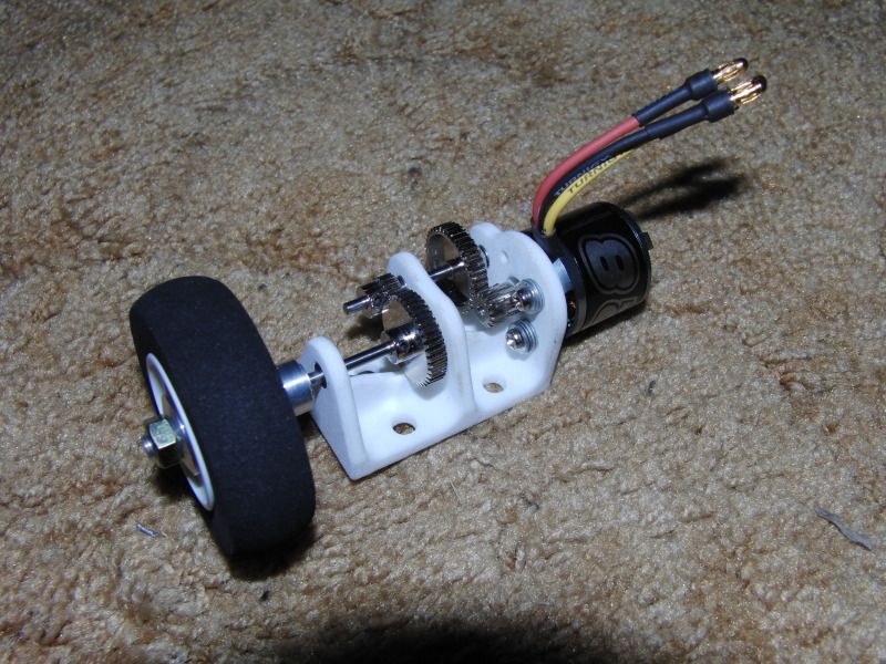

Second question. In my beetle weight brushless gearbox I used Shapeways to print the gearbox housing which I then bolted into a biscuit tin. I was plaining to use the same thing in Vendetta, with a 3D printed housing that matched the scooter motor bolt pattern.
Here's a piccy of what I did with the beetle.
