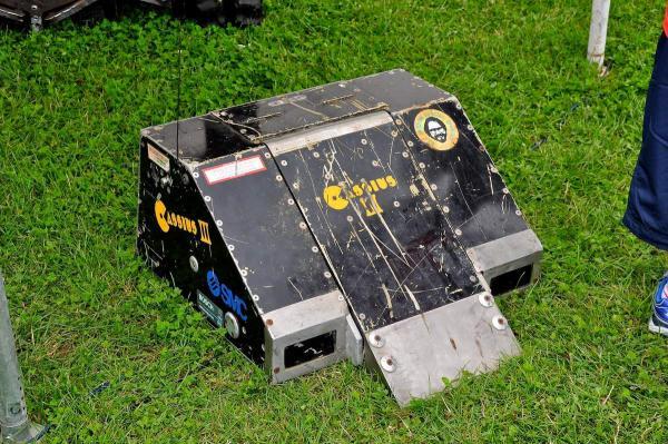

Looks like it was just the flipper arm (always wondered what that was!) Isn't the rest Polycarb? Dunno about the base plate.
Also looks like Cassius 3 actually ran:
It has battle scars. I guess we now know where the Invade guys got their inspiration for Explosion....
Does anyone know if it was built with the 4 bosch400 set up?
Years ago I went to a robot event (in Norwich, dunno who) and Cassisus was meant to be there, but never ran.
