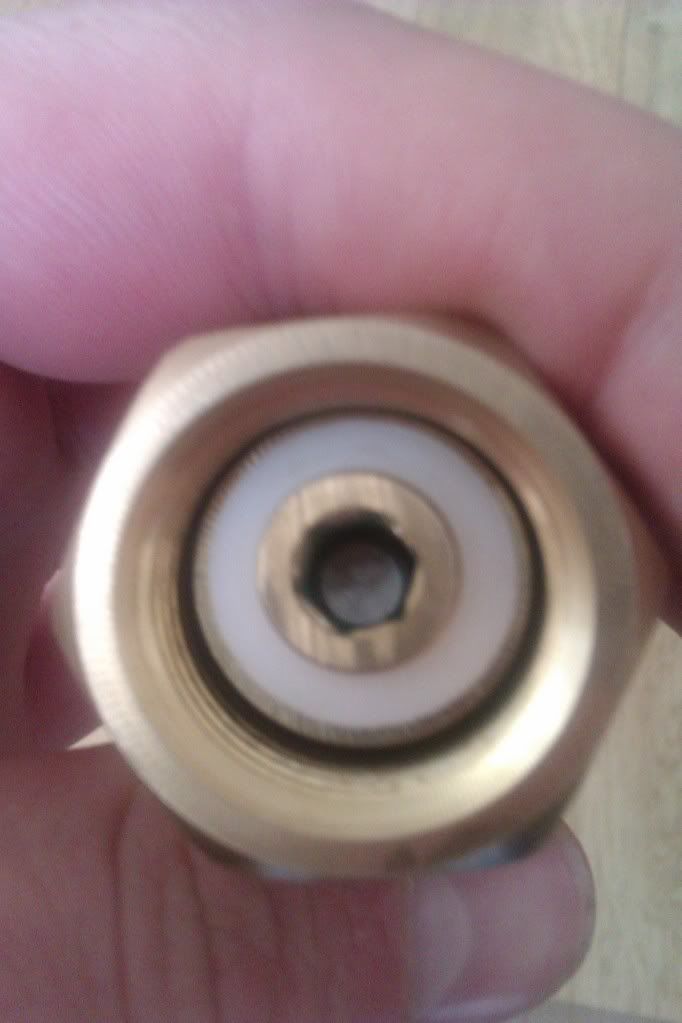

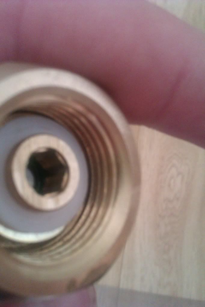

                              pictures of the reg and bottle
                              • #30
                                Re: Pneumatic Fittings

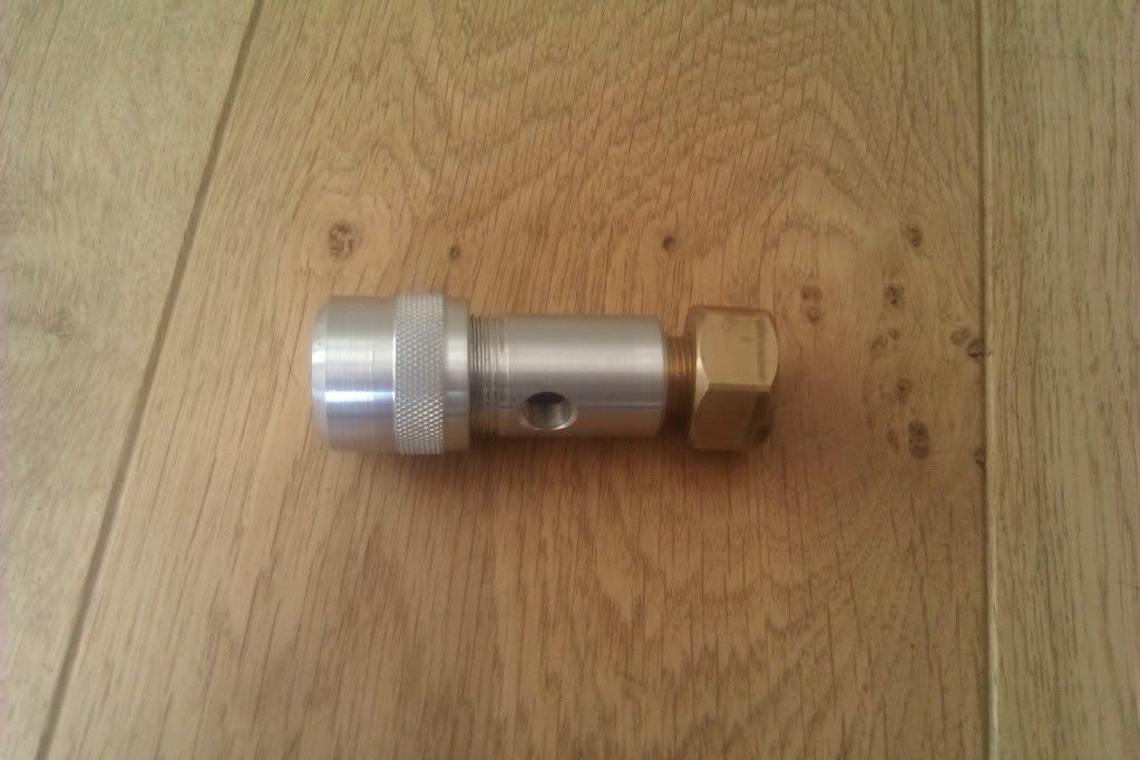

                                OK you have a std European co2 nut on the reg ... and an American / paintball thread .
                                I'd suggest perhaps getting the ASA paintball adaptor with the side entry... then hacksaw a thread off a fire extinguisher and tap the middle bsp.... you could do this yourself ..or ask Mario ..or I could at a pinch be persuaded.
                                You then you just need a nipple between the two.
