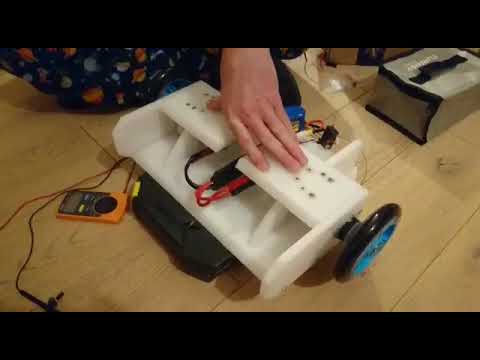

Having absolutely zero points of reference for how to start designing a robot, I had to spend some time vaguely figuring out the layout for the thing in my head. I've been trying to figure out Fusion 360 for the last year so I fired it up and started sketching. My current level of expertise with F360 consists of frowning at the computer and wondering why it has to be different from SolidWorks.
The two drive motors and the weapon gear motor were the only known quantities, so most of the chassis was designed around fitting them in. I then added a box on the back that could accommodate something around the size of a 4s 3000 mAh LiPo plus some extra space for other electr(on)ic gubbins.
The fruits of my initial CAD work, after a couple of days' work:
Mostly made of HDPE, wheels at this point completely unknown provenance (other than "about 120 mm diameter"). The front prong/wedge and sides of the overhead grabby arm were meant to be made from some steel bar bought from eBay, with teeth made from M6 stud. The mount for the gearmotor is designed to be cut from a piece of scrap ally that I saved from the bin at work.
