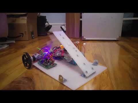

I wasn't originally intending to attend Rapture in Chatham but as a space was free, I've said I would. Had a bit of a mare trying to find the robot since house moving has meant everything is currently hidden and all over the place. I will be spending a evening or two getting the damage repaired from Slav King and seeing if I can move the wheels inbound so they aren't whipped off after 5 seconds.
After Rapture, I'll be rebuilding the shell yet again. I am not sure if the flipper motor is working properly so will be taking the chance to replace that to transform this into the planned 4.2 version.
