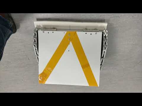

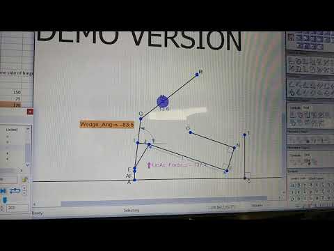

So far I have been focusing on getting the frame and mechanism just right. For the flipping/self righting mechanism, I found a program called Mechanical Expressions to be particularly useful, building a 2D structure, and applying the load of another robot on top.
The video shows a cross section of the robot, cut through the LinAc. The video shows that I can transition the top panel from 45 to over 100 degrees, all with the weight of another robot on top; while staying inside the LA's force limit of 750N.

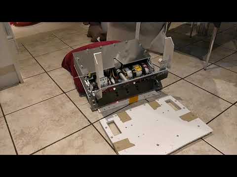

I have also created the basic circuitry, and placed it in a testing chassis made from an off-cut plastic window ledge out of a skip.
I've started ordering a lot of the hardware now, so exciting times. Any thoughts and suggestions welcome.
