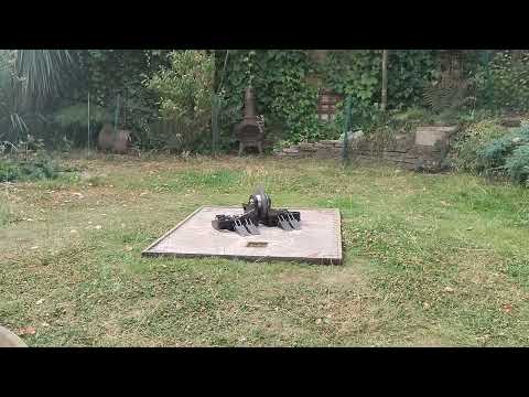

      Aha hey so I forgot I had a build diary again! Progress has been a lot slower than expected because ~money~ but she spins and she drives and she was gonna be at Dojo on Sunday but there were literally 2 robots going so it's off, anyway maybe I'll do the next one and maybe also Extreme Robots we'll see how things work out
      New weapon motor is a beast, check that spinup time!
