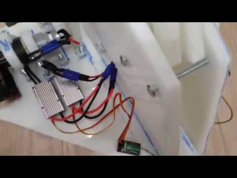

    So... been a while since I've updated the build diary, but thankfully, today, me and my friend has managed to get the wheels onto Ratatoskr. Ended up buying the wheels from RogueTwoRobots, and they fit perfectly onto the robot, no loose wheels, nothing. All we would need to do is tape up the link to a safer place, which in turn pulls the wires away from the robot motor.
    My friend, Sid, held the camera for this one, but it pretty much shows the progress we had made, but it also shows how scatterbrained we are, haha.

      Gratz on getting it moving. I spy the tupperware box the battery is in, looks similar to what I use in The Honey Badger. I can use some foam padding or even a couple of folded shopping bags to keep my batteries in place along with a lid.
      You would need to consider adding a guard or using some cable ties to keep the wiring away from the wheels mind to prevent them being chewed up. Surprised it weighs 6.6kg though - mine weighs 9.6kg all finished.

          Oh don't worry, I don't plan on leaving the battery loose, that was just for the test drive. Soon as we get the weapon on the bot, I'm gonna stick it down with velcro tape and cushion it with packaging foam, but I will put a more intact tupperware box in instead of a cut up one haha.

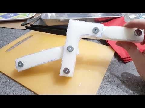

                  So, after a long 2 hours work... we've got something that resembles an axe mechanism... or at least something as close to a motorised version of shunt... that isn't motorised, haha.
                  As you can see, it's not completely finished yet, there's still a lot of cutting and slotting to do, we just didn't have the time to do it as we were losing daylight as the time went on. But hopefully at some point either tomorrow or next week, we'll have the axe mechanism in Ratatoskr... and fingers crossed, not have it blow up in our scruffy bearded faces.

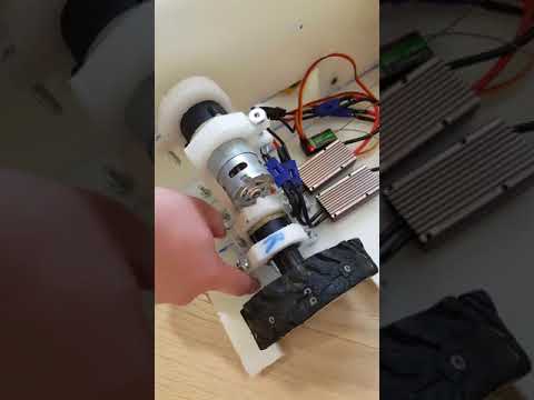

                    intresting what weapon motor are you using ? wasn't it a 350w scooter ?
                    • #40
                      Nah, it's going to be the same motors, the 18v drill motor that is up there in the middle of nowhere on the test drive of Ratatoskr. If need be, there'll be some weight reduction, but, also, if need be, I can always try and drum up some money for a scooter motor if needed.

                        yes i spotted it after i posted, i am tired. bit worried that it will either be not strong enough to self-right

                          Well if it doesn't, then I'll have to fix that bridge on the way of crossing it... if that makes any sense. Basically if it doesn't flip it, I'll look into a more powerful motor.

                            not sure one would be enough but a a RS775 or aTorpedo 850 might be a good candidate if you dont want to use a scooter motor

                              So I managed to mount the mechanism onto Ratatoskr, and although it's a rather snug fit, just a little bit of wear and tear will smooth it all out and should mean that it'll run smoother too.
                              I apologise for the shaky/crap camera positioning and the shoddy commentary, but handling my tremors is not one of my strong suits. (Doesn't help that I just finished using the jigsaw cutter too.)
                              So I just need to do a little more work on the mechanism, and it should (don't quote me on this) work smoothly. The amount of time I've had on this has been quite... troublesome, considering the weather, the material and the fact that my friend's been out of action thanks to illness. But the finish line is getting closer and closer... I just need more time.
                              Hopefully tomorrow, I'll be able to get more of the cutting done if the weather stays right, then reassemble, remount and hand-test the motion of the mechanism again. If that goes smoothly, then I can get straight on with the wiring, mount the link sections properly, and get those batteries in a more suitable protected area. I have a couple more takeaway boxes from asda ding meals that I can just cut and test if need be, and if that fits and works, I can tie it all down and get working on the armour.

                                So I just managed to sort out the long piece that was being a hindrance, and now it works fairly smoothly, although I may need to make the hole connecting long piece to L pieces a little longer, but that'd be for another time.
                                So with a little wear and tear, it'll more than likely run better than I expected. So tomorrow or day after, I should be able to solder up and connect the last of the wiring, and replace the lights. Then that'd be that done and I can finally move onto the armouring... and figure out how to apply to the Manchester event, haha.
