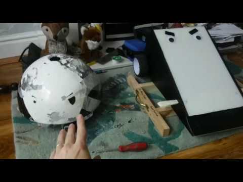

        • #94
          To cap this off until after Stevenage (at least), here is the run through video with a side by side comparison with the 1.0 version.
